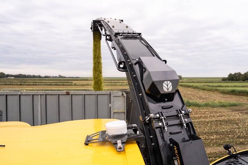

New Holland is adding AI-powered machine vision to its FR Forage Cruiser lineup with ForageCam, a system that measures kernel processing scores (KPS) in real time as chopped corn leaves the harvester. A spout-mounted camera analyzes the material and displays the resulting score on the IntelliView IV Plus display. At the same time, the system can automatically adjust the kernel processor to maintain an operator-selected target. Available for the 2027 season, ForageCam also records KPS and mapping data for later review through FieldOps, giving operators a way to monitor and manage forage quality without relying on manual inspection or laboratory testing.
New Holland’s ForageCam uses a spout-mounted camera and AI-based vision to monitor kernel processing.
New Holland’s ForageCam uses a spout-mounted camera and AI-based vision to monitor kernel processing. Images used courtesy of CNH
Instead of relying on a visual estimate or waiting for a sample to be analyzed, operators can see KPS while harvesting. ForageCam compares the measured score against a target selected by the operator and uses that information to adjust the kernel processor automatically. The goal is to maintain the required forage quality without running the processor more aggressively than necessary.

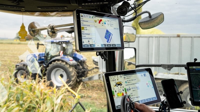

ForageCam kernel processing scores and harvest data can be monitored in real time on the IntelliView IV Plus display.
ForageCam kernel processing scores and harvest data can be monitored in real time on the IntelliView IV Plus display. Image used courtesy of CNH
ForageCam moves that measurement onto the machine. The camera is mounted on the spout, where it continuously views chopped material as it leaves the harvester. AI-based vision determines the percentage of fully processed kernels and compares the result with the operator's target KPS. The operator can view that score in the cab on New Holland's IntelliView IV Plus display. At the same time, ForageCam records KPS and mapping information that can later be reviewed in FieldOps through reports and map layers.

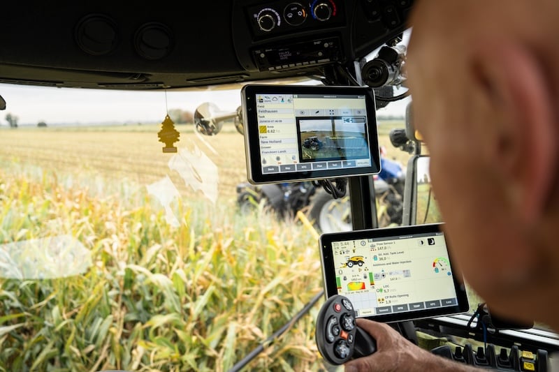

Operators can view ForageCam data from the cab while harvesting and make adjustments based on current kernel processing conditions.
Operators can view ForageCam data from the cab while harvesting and make adjustments based on current kernel processing conditions. Image used courtesy of CNH
ForageCam moves that measurement onto the machine. The spout-mounted camera continuously views chopped material as it leaves the harvester, using AI-based vision to determine the percentage of fully processed kernels and compare it with the operator's target KPS. The score can be viewed in the cab on New Holland's IntelliView IV Plus display, while KPS and mapping data can also be reviewed later through FieldOps using reports and map layers.
