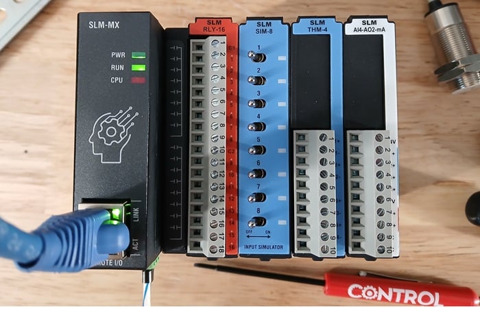

The SLM system from Synergy Logic is a chassis-free, modular remote I/O system. It consists of only one option for the bus coupler: Modbus TCP. This protocol is fairly universal (as much as possible in the world of automation).
This system contains the bus coupler, a 16x relay (discrete) output card, an 8x discrete input card (simulated with switches), a 4x thermocouple input card, and an analog combination 2x in/2x out card.

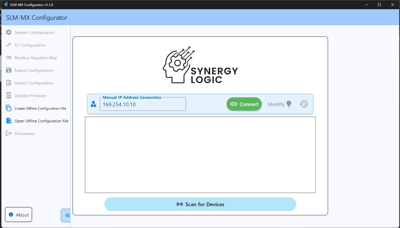

Inside the SLM-MX, DHCP is enabled by default. However, if you are connecting to the PLC and a laptop, a DHCP server isn’t usually a standard option, so we must take note of the default IP address: 169.254.10.10.
Change your laptop’s network configuration to a subnet that is similar, perhaps with the address of 169.254.10.2. You will now be able to change the IP address of the SLM to communicate with your PLC.
Download and install the MX configurator software. Open the software, type in the default IP address of the SLM, and press the green Connect button.

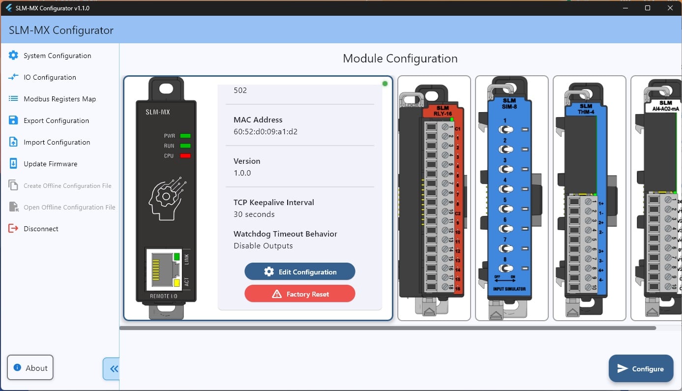

When the SLM system is identified, click on the bus coupler and ‘Edit Configuration.’

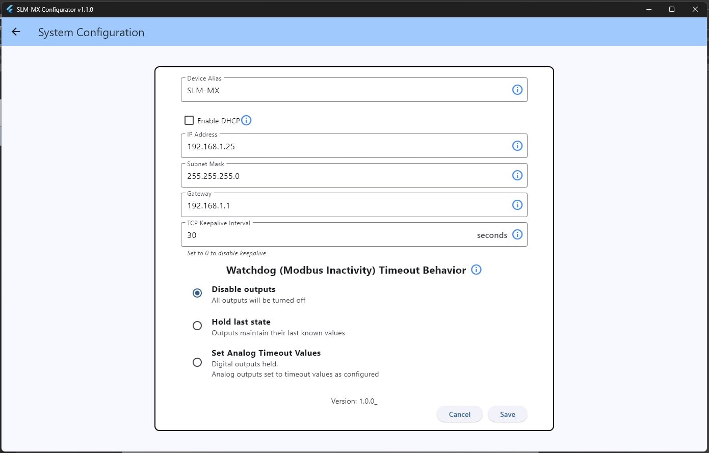

Set your parameters and click 'Save.'

On my benchtop setup, my PLC and computer are both on the local 192.168.1.xxx network, so this is my chosen IP address.
The SLM configuration is now complete.

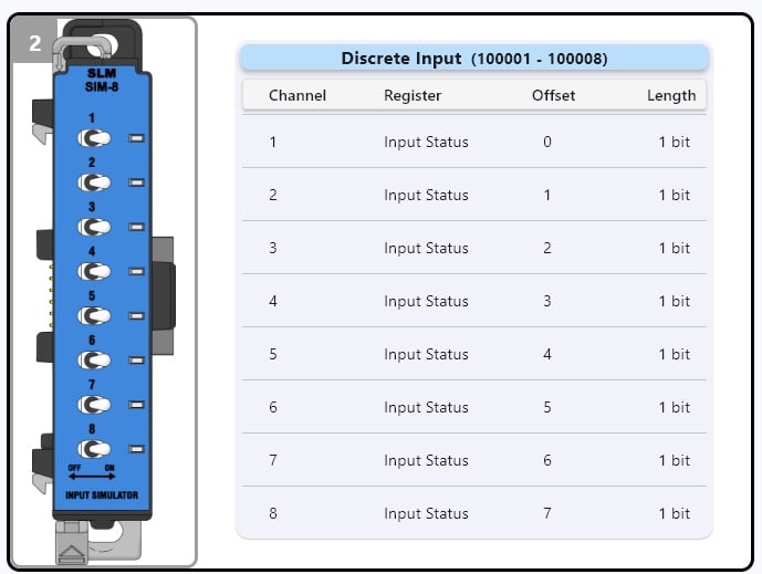

While you have the software open, you can check the Modbus addresses to keep them in mind for later. Click ‘Modbus Mapping’ on the sidebar and all modules will be displayed. This is standard Modbus addressing, where the prefix determines the type: 0xxxxx is for coils, 1xxxxx for contacts, 3xxxxx for register (analog) inputs, and 4xxxxx for register (analog) outputs.
This hardware setup is fairly easy; for example, the simulator input contains addresses 100001-100008. Since 1xxxxx always refers to inputs, we only need to note the final address number, 1-8. If I had a second card, it would show 100009-100016, referring to inputs 9-16.
 Figure 5. Modbus IO map for this module.
What this tells us is that when we run the Modbus transactions for this module later, we just need to point at the SLM-MX IP address and tell it we want to ‘read the first 8 discrete inputs.’

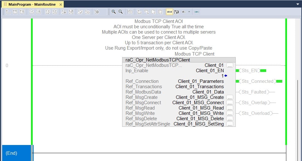

3. Install Rockwell’s Modbus Client AOI
Studio 5000 does not have a built-in Modbus read/write function block, but there is a simple solution. Go to the Rockwell support site and download the pre-built Modbus TCP AOI. Extract this folder.
Open a recent or new Studio 5000 project, but this is actually an L5X file type which is a logic package, so don’t immediately ‘Import AOI.’ Instead, add a rung where you wish to perform the Modbus read/write and ‘Import Rungs’ in the ladder routine. Choose the “TCP Client” logic file.
The rung will now contain a single instruction capable of reading and writing many Modbus instructions all in one command, with the default name of “Client_01.”

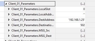

IP Address of the SLM-MX
First, we need to set the remote IP address. In the controller tags list, expand Client_01_Parameters -> .DestAddress. This is a STRING data type, so double-click and add the IP address between the delimiting quote marks.
 Figure 7. Setting target IP address.

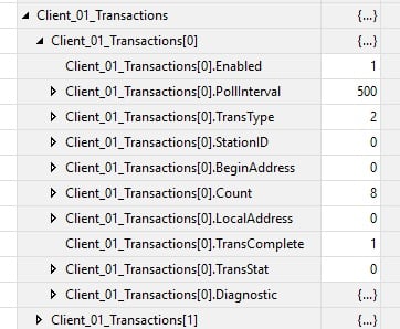

Read the Inputs
There are several available transactions, and we’ll use one for the inputs and another for the outputs.
For the inputs, use the image below as an example.
  • Enable the transaction
  • Change the polling delay interval (if you want)
  • Transaction type is 2 (more about Modbus function codes here)
  • Beginning address is a bit tricky; address 0 actually refers to the starting Modbus logical address of xxxxx1. So we choose a starting address of 0, and it will retrieve address 100001. If you want to understand this number shift, search online for “Modbus zero-based addressing.”
  • Count is 8, meaning we’ll read 8 consecutive Modbus inputs.
  • Local Address is the starting array index of the DiscInputs tag where the values will be stored. Leave this 0 for now, but if you needed to read 8 inputs here, and then read another 8 inputs later, you would want to store those new ones with a starting address of 8 so they don’t over-write these values.
 Figure 8. Transaction for reading inputs.

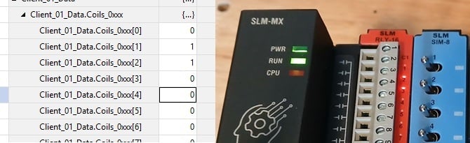

Write the Outputs

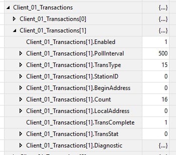

The transactions for a “multiple coil write” action will look quite similar. This time, the transaction type is 15 (multiple coil write) and we are counting 16 consecutive terminals, because it’s a 16 relay output module.
 Figure 9. Transaction for writing to outputs.

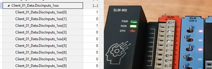

Download the code to the PLC, and set the Main rung instruction Inp_Enable to 1.
5. Read/Write the Data
Flip a few switches on the input module and open the Client_01_Data DiscInputs array tag. You should see the Bools reflecting the real-world state of the module.
 Figure 10.
Figure 10. Verifying inputs - they work!
Similarly, open the Coils tag and place a couple of 1 values into a few spots. The relay module should energize accordingly.
 Figure 11.
Figure 11. And the outputs - they work too!
