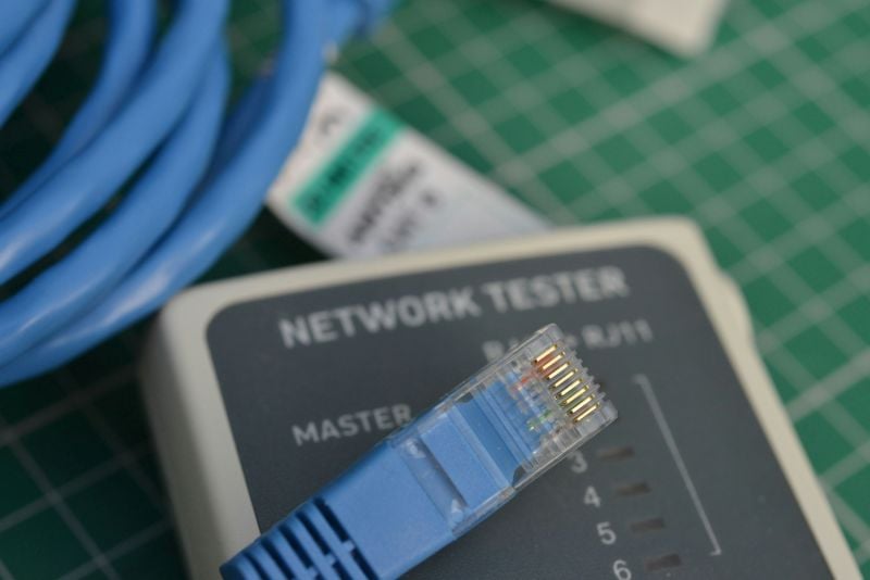

An RJ45 connection for standard Ethernet communications
An RJ45 connection for standard Ethernet communications. Image used courtesy of Unsplash
