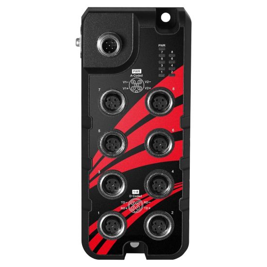

Antaira’s new LNX-0800-M12-67 series features an IP67 housing and industrial M12 connectors to withstand water and vibration
Antaira’s new LNX-0800-M12-67 series features an IP67 housing and industrial M12 connectors to withstand water and vibration. Image used courtesy of Antaira
IP67 Unmanaged Ethernet Switches
Instead of the usual RJ45 jacks, Antaira’s LNX-0800-M12-67 series of Fast Ethernet unmanaged switches uses an M12 D-coded connector for all eight data ports. This means a secure, locking fit that resists vibration common on train cars, trackside equipment, or factory machinery. There’s also a dedicated M12 A-coded connector for power, so the supply line is just as secure as the data lines.
Power input ranges from 12 to 48 VDC, making the switches adaptable to various setups and handy for redundant power schemes. The housing itself meets IP67 requirements, shrugging off dust and handling water exposure without losing its seal. For installers, this resistance means less worrying about enclosures and more freedom in installation location.

The LNX-0800-M12-67 switches feature eight 10/100BASE-TX ports with M12 D-coded connectors and one M12 A-coded connector port
The LNX-0800-M12-67 switches feature eight 10/100BASE-TX ports with M12 D-coded connectors and one M12 A-coded connector port. Image used courtesy of Antaira
The LNX-0800-M12-67 switch itself comes in two temperature ratings: -10 °C to 65 °C for the series’ standard model and -40 °C to 75 °C for the series “T” model, suitable for extreme environments.
