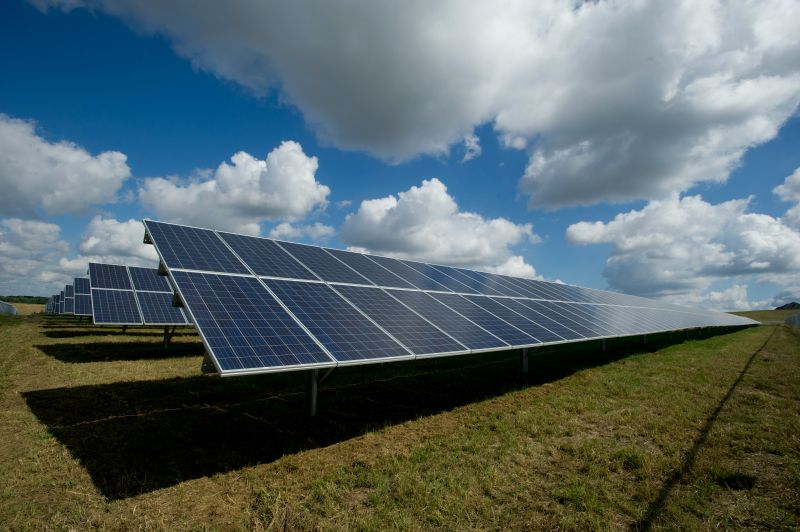

SPE technology could benefit remote applications, such as an unmanned solar farm that produces large amounts of power
SPE technology could benefit remote applications, such as an unmanned solar farm that produces large amounts of power. Image used courtesy of Unsplash
Remote Automation
There are many applications where sensors are used in remote, unattended locations. Solar farms and oil fields are just some examples where temperature, pressure, or electrical measurements need to be monitored. What if these sensors could connect to the internet, and a remote SCADA system could display their values? Technicians would simply log into a web page and view the sensor data in real time. With SPE technology and devices like the new unmanaged SPE switch from Weidmuller, this hypothetical situation might just become reality.
