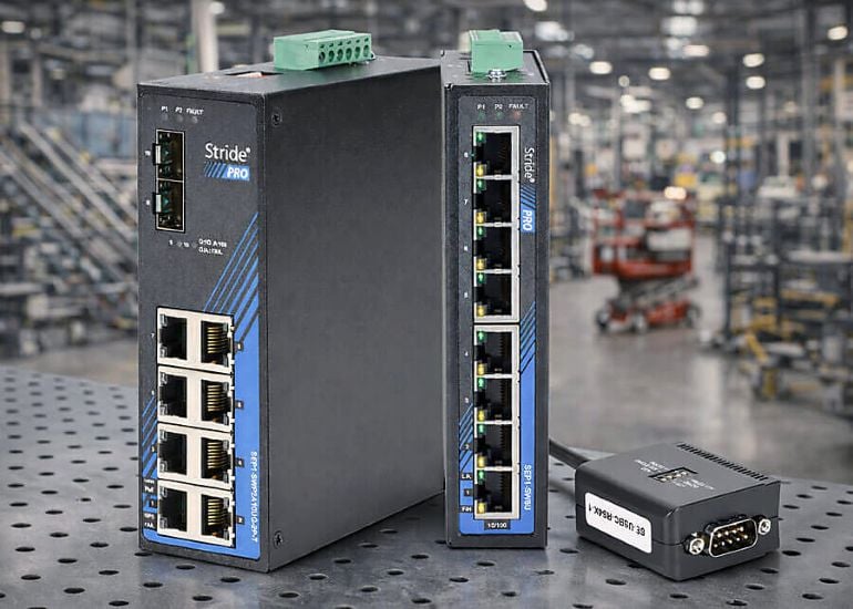

The Stride Pro Unmanaged+ industrial Ethernet switches offer advanced networking features
The Stride Pro Unmanaged+ industrial Ethernet switches offer advanced networking features. Image used courtesy of AutomationDirect

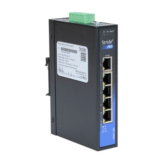

The SEP1-SW5U Stride Pro industrial Unmanaged+ Ethernet switch features five ports
The SEP1-SW5U Stride Pro industrial Unmanaged+ Ethernet switch features five ports. Image used courtesy of AutomationDirect
