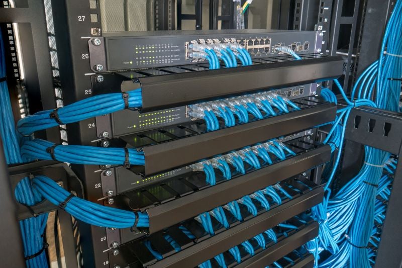

Ethernet switches play an important role in transmitting and receiving data in industrial applications
Ethernet switches play an important role in transmitting and receiving data in industrial applications. Image used courtesy of Adobe Stock
