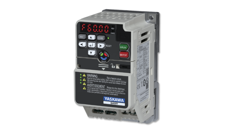

Yaskawa America’s new GA501 is a compact AC variable frequency drive (VFD) with integrated dual Ethernet ports, capable of supporting one of six industrial protocols. The GA501 is designed for modern automation and supports motor sizes from 1/6 HP to 40 HP.
Yaskawa’s industrial AC microdrive features dual-port embedded Ethernet
Yaskawa’s industrial AC microdrive features dual-port embedded Ethernet. Image used courtesy of Yaskawa America
The GA501 AC Microdrive
Yaskawa’s GA501 industrial AC microdrive comes in three different versions supporting three voltage types: 240 VAC single-phase, 240 VAC three-phase, and 480 VAC three-phase. The different voltages support three motor ranges: 1/6 HP to 5 HP, 1/6 HP to 30 HP, and 1/2 HP to 40 HP, respectively.
The integrated dual Ethernet port allows virtually any control system to communicate with the drive. Simply set the dip switches to configure the drive for either Ethernet/IP, Profinet, EtherCAT, BACnet/IP, or MECHATROLINK-4. The dual Ethernet ports enable technicians to connect multiple GA501s or other devices in a ring topology.
An integrated status ring and network LED on the front of the device display the drive and network connection statuses at a glance. Programming the drive can be done with the LED display and integrated buttons or through Yaskawa’s desktop or mobile DriveWizard app.

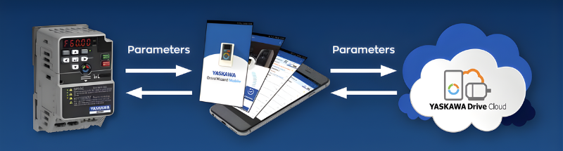

A representation of the DriveWizard mobile app and how it stores and transfers parameters
A representation of the DriveWizard mobile app and how it stores and transfers parameters. Image used courtesy of Yaskawa America
Programming Without Power
Most drives have an LCD screen and some buttons to facilitate setting parameters on the drive, essentially programming the drive. This activity can only be performed with the drive installed and powered on. The GA501 drive uses the DriveWizard mobile application to allow a user to program the parameters without power applied to the drive. Simply connect a cable to the drive and a mobile device, and parameters can be set without even taking the drive out of the box, saving customer downtime and speeding up integration.
The mobile app also allows parameters and configurations to be saved to a cloud account for drive recovery or in the case of replacement. For locations that do not always have internet access, drive parameters can be downloaded to a device and then applied to the drive.

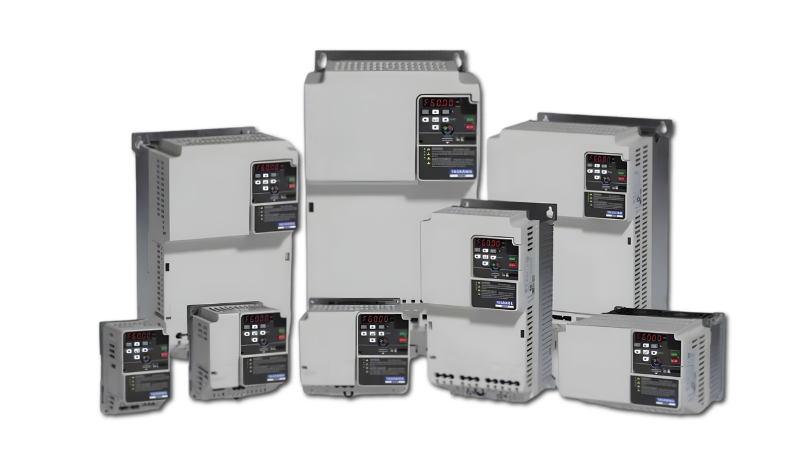

The GA501 is available in different enclosure types and ratings
The GA501 is available in different enclosure types and ratings. Image used courtesy of Yaskawa America
