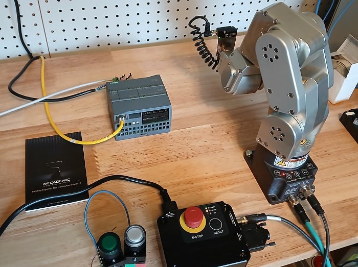

Hardware Setup
This project includes the PLC, the robot, and the computer.

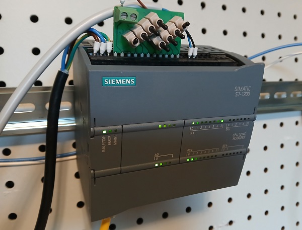

The PLC uses several digital inputs, which can be provided via external switches or the handy I/O switch simulator board provided by Siemens (6ES72741-XF30-0XA0). We will get started with a pre-built project provided by Mecademic, and this project requires inputs %I0.0 and %I0.7. I recommend selector switches, not momentary pushbuttons.
 Figure 2. The PLC with the simplautor board and two additional pushbuttons.
The PLC is connected to an unmanaged switch.
The Meca500 robot and the PC are also connected to the switch. The PC must contain a web browser and TIA Portal (again, version 14 or above).

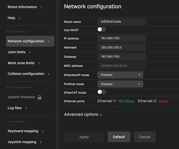

Activate PROFINET on the Robot
Before we can use the Siemens PLC to command the robot, we must activate PROFINET.
Open a web browser and type in 192.168.1.100, the web server for MecaPortal. If the robot’s IP address has been changed, use that address instead.
Make sure the robot is disconnected from any other PLC, then activate it and switch to ‘control mode’ in MecaPortal. In the top-left corner menu, open Network Configuration and enable Profinet mode.
 Figure 3. Activating Profinet mode.
You can now close the web server. It won’t be needed any longer in this project.

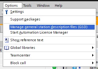

Download the firmware package; this zipped folder also contains the EDS, GSDML, and ESI files for various protocols. Extract the downloaded folder, open it, and then open the ‘protocols’ folder.
In the TIA Portal project, open Options -> Manage general station description files (GSD). Choose the folder path from that firmware folder and install.
 Figure 4. Installing a GSDML file.

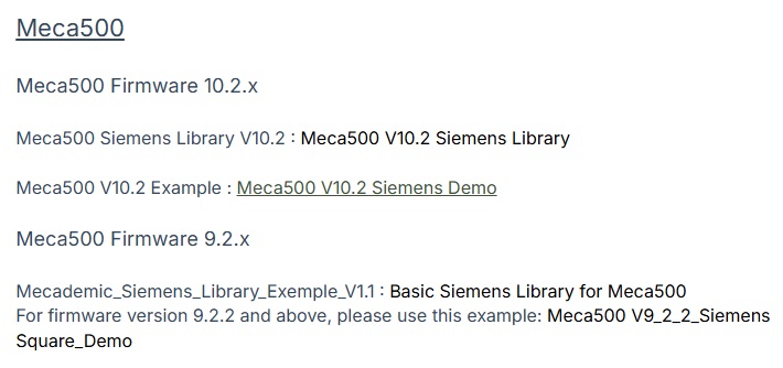

PLC Project Code
Although we could design a project from scratch, there is no sense in re-inventing the wheel. It would be quite complex since the function library is very extensive.
This Siemens PLC integration page contains the library and example projects. For this intro, we will use the full project and make some changes. Scroll down and download “Meca500 V10.2 Siemens Demo.”
 Figure 5. Project source file.

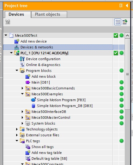

Open TIA Portal, then select and open the newly downloaded project file. It has a .zap16 file extension. I would suggest immediately “Save As” with a new name, just so you keep the original backup. I called mine Meca500Test.

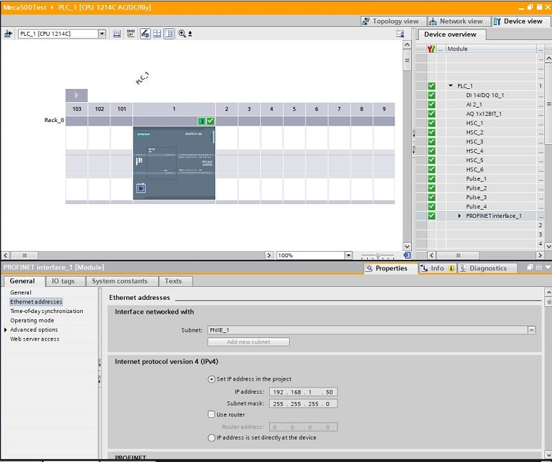

Since this project already has the PLC and the robot added, the IP addresses will need to be verified before downloading. Double-click on Devices & networks in the project tree.
 Figure 6. Accessing the project devices.
Next, double-click on each of the network ports one at a time and make sure the IP addresses match your actual devices.
 Figure 7. Editing device IP addresses.
Hopefully it should go without saying: make sure the PLC, robot, and computer are all on the same subnet.

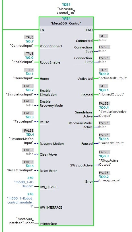

The Main program block contains only two networks. The first function, Meca500_Control, provides the connection and enabling of the robot. Activating digital inputs 0 and 7 should achieve this connection.
 Figure 8. The necessary ‘Control’ function block.

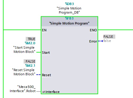

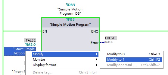

The next network calls a simple motion program, which is a sequence of a few XYZ target point move commands.
 Figure 9. Default motion program function block.
To test the program: clear the area in front of the robot and modify %M2.0 to 1.
 Figure 10. Running the default motion program.
The robot should make a few linear moves and return to a joint position of (0,0,0,0,0,0).

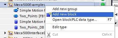

Create a new block under the Examples folder.
 Figure 11. Adding a new function block.

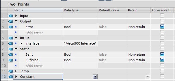

Create a new Function Block (FB) and call it ‘Two_Points.”
This function block will require a few input and output variables, because they are fed into the Move functions.
Two_Points FB:
Inside this new function block, populate it with the following variables:
Error, Interface, Sent, and Buffered. Note the category and data type for each one.
 Figure 12. Function block variable list.

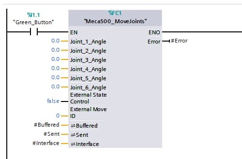

Next, we can add the move functions to the ladder networks. The first rung will use the green button input to drive the robot back to the zero position, so we will use a MoiveJoints function. Add the input and output variables as shown below.
 Figure 13. First motion instruction.

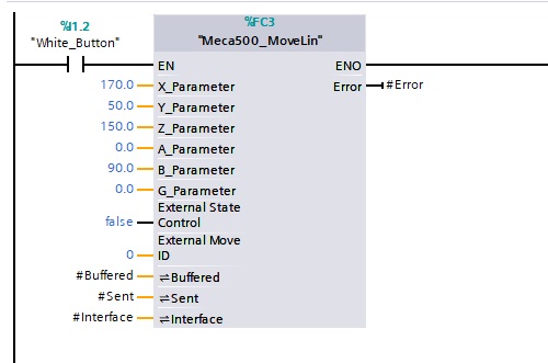

Next, we’ll add a linear move command to the next rung, driven by the white button. The positional values are arbitrary, but be sure to choose a position that is A) reachable, and B) does not collide with objects in your workspace.
 Figure 14. Second motion instruction.
