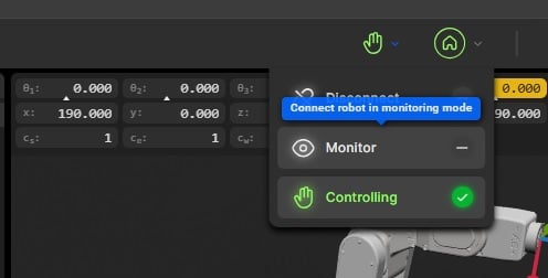

In the connection mode menu, switch to monitor instead of controling.
 Figure 3. Activate Monitoring mode.
This step is important because in the PLC, we can choose whether to run the robot from the PLC or from MecaPortal. If the commands should come from the PLC, you must switch to monitor first. If the commands should come from MecaPortal, then switch to controling.

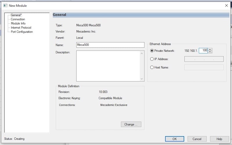

Right-click on the Ethernet adapter in the controller organizer of Studio 5000 and add a new module while offline. Add a new Meca500 and use the IP address that you supplied in the first step.
 Figure 6. Add a new robot to the Studio 5000 project.
Whatever name you choose for the robot will be used in the motion commands later, so if you plan to use multiple robots, name them properly for the sake of project organization.
Download the new configuration to the PLC, go online, and the PLC should recognize the robot with a steady I/O OK light.

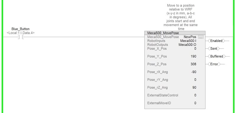

In the second rung, add a MovePose command with a digital input. This example will simply move the robot to this point when the input is energized. You may calculate the coordinates with CAD data, calculations, or by jogging in PC control. I used the position of (0, 190, 308, -90, 0, 90). This is a simple rotation of the base joint by 90 degrees.

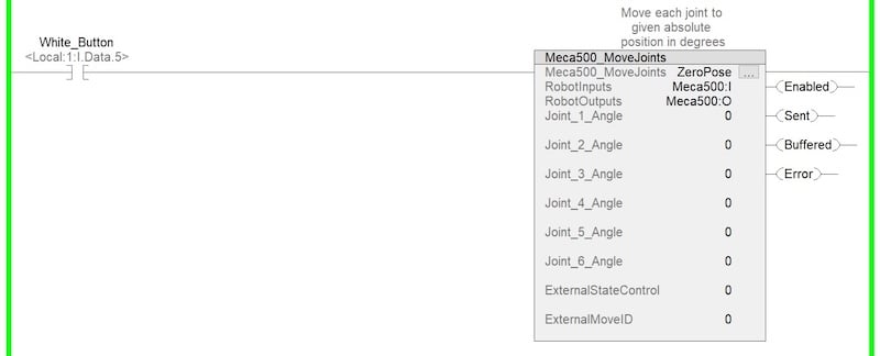

In the third rung, add a MoveJoints block with all joint values equal to zero. This is the same as zeroing the robot, but added as a command block. Allow this rung to run when another digital input is energized.

Activate the digital input attached to the MovePose command, and the robot should move. Then activate the input for the MoveJoints zero command, and the robot should move again.

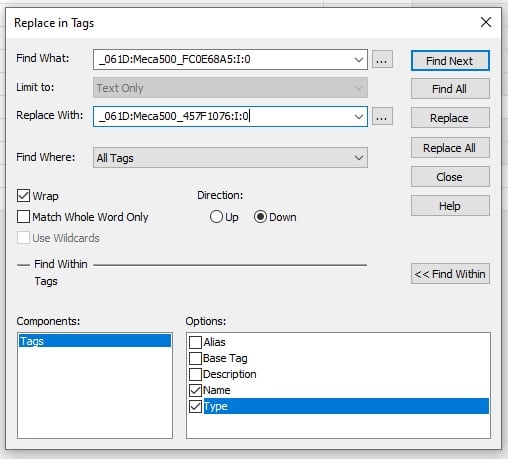

These three things must match: the robot FW version, the EDS version, and the AOI version.
If the AOI does not match the robot and EDS version, there will be a problem importing because the data types do not match. To fix, install the EDS and import the AOI, ignoring warnings in this second step.
After importing, look into the module-defined data types. _061D:Meca500_xxxxxxxx:I:0 and _061D:Meca500_xxxxxxxx:O:0 refer to the current data types provided in the EDS.
Now, look at one of the add-on instructions, for example, Meca500_Delay. Open the Parameters and Local Tags.
The two tags RobotInputs and RobotOutputs are defined by the AOI version. Look in the Data Types column, and the xxxxxxxx numbers may not match. This same tag appears in many of the AOI instructions.
Open the Replace utility in the search menu. Expand the Find Within field and select Type.
  • “Find What”: the old data type that currently exists in the Parameters and Local Tags of the AOI instructions.
  • “Replace With”: The new data type as it appears in the Module-Defined Data Types folder.
 Figure 10. Replacing the old data type with a new data type.
My solution is shown above. Replace all instances, then download the program, and the errors should resolve.
