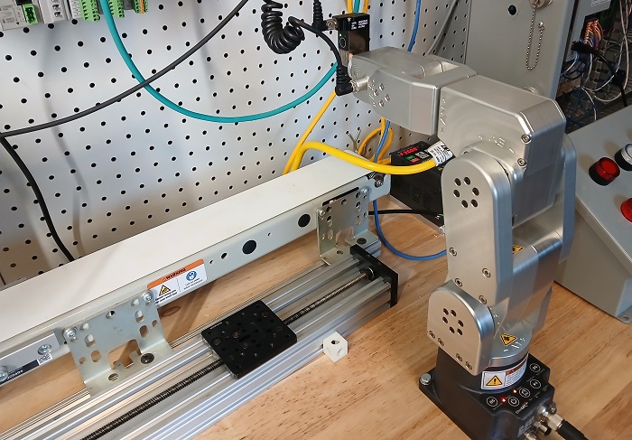

 Figure 1. The Meca500 contains all the drive electronics in the base.
In contrast, the Meca500 contains all of the drive electronics (the controller) in the base. There is a separate box that connects the robot to AC line power, as well as an access point for an e-stop button and other safety inputs. Further, the Meca500 doesn't use a teach pendant. Instead, it uses an Ethernet connection and a built-in web server, so that any computer on the local network becomes the programming interface.

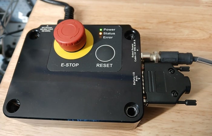

Before connecting the plug to the power outlet, connect the safety and power supply box to the robot base. Also, connect the safety circuit or attach the dongle included with the robot. This dongle bypasses the safety circuit, to be used only in prototyping or in a safe learning environment. Finally, connect the network cable from the robot base to the programming PC with a web browser.
 Figure 2. The power supply and safety I/O control box.

After the hardware is connected, plug in the power cord to the 120 VAC socket and press the power switch on the safety control box. Press the Reset button on the control box, and the lights will activate on the robot base and begin blinking.

  • Is the power box supplying power to the robot? The dongle or safety circuits should be connected to the Safety I/O port, and the E-Stop button should be released.

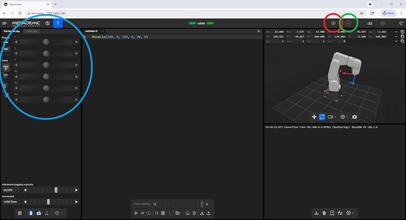

When the MecaPortal web server is accessed and the page loaded, we will need to activate and home the robot.
To place the robot into the web control mode, click on the Monitoring icon at the top menu (it looks like an eye). Select the Control mode, and the button icon should turn into a hand.
Next, activate and home the robot by clicking on the power icon (directly next to the control mode button). The robot can be activated and homed from this menu, or both at the same time.
Now the robot can be jogged.
 Figure 4. MecaPortal web interface. The red circle switches connection operating modes, the green circle activates the robot, and the blue section is the jogging interface.
Figure 3. MecaPortal web interface. The red circle switches connection operating modes, the green circle activates the robot, and the blue section is the jogging interface.
The jogging can be done in joint, world, or tool coordinate systems, much like any other robot. In the web server interface, buttons on the far left side can toggle between the different jog modes, along with buttons and entry boxes for jogging or entering an absolute value. When in tool or world systems, you can jog the robot along a single plane, either xy, yx, or xz.
The various coordinate systems are Cartesian (x, y, z) systems, but there are subtle differences in function between each of them. The base reference frame (BRF) is static, fixed to the ground at the attachment point of the robot to its fixture. The world reference frame (WRF) is, by default, aligned with the BRF, but it can be moved to a point that aligns with external equipment to simplify the jogging and teaching process. Finally, the tool reference frame (TRF) is a point that aligns with the gripping location, so it must be set for each custom gripper. Fortunately, many grippers are predefined in the software, so the TRF is automatically applied when the tool is selected. The tool system uses the flange at J6 as its default reference point, so if you rotate the wrist, it will also rotate the x, y, and z directions of motion.

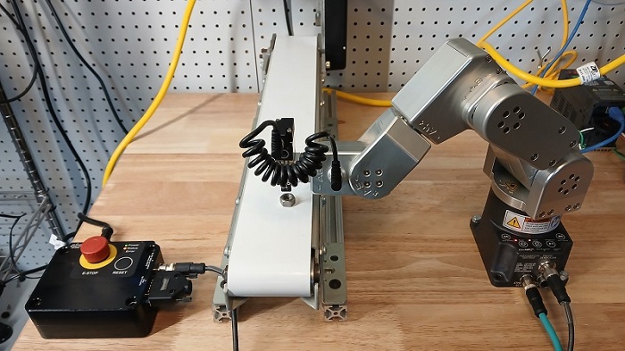

 Figure 4. An example pick-and-place system with the Meca500 robot.
