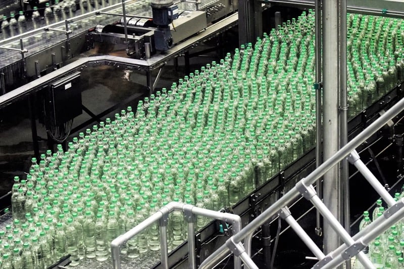

A bottling line that uses conveyors driven by AC motors to move bottles around the plant.
A bottling line that uses conveyors driven by AC motors to move bottles around the plant. Image used courtesy of Unsplash

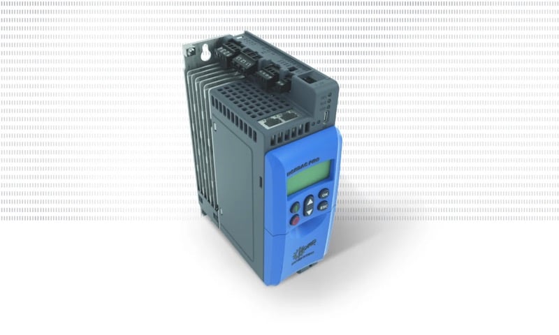

The NORDAC Pro
The NORDAC Pro is a compact VFD designed to be installed in proximity to other NORDAC VFDs. There are three variants: basic, advanced, and advanced with Ethernet. The basic version includes integrated safety STO and SS1 signals, along with brake chopper, POSICON, and PLC interface. The advanced version adds expanded functionality with TTL encoders, additional I/O, and Bluetooth connectivity. A microSD card slot is provided, enabling transfer of parameters between drives. The advanced version with Ethernet offers the same features as the advanced version with a multi-protocol Ethernet port supporting protocols such as ProfiNet, EtherCAT, EtherNet, and PowerLink.
All variants utilize single- or three-phase power, 200-240 VAC or 380-480 VAC. Parameters can be set using the integrated LCD screen and soft-touch buttons, a plug-in control module, or the NORDCON software tool.

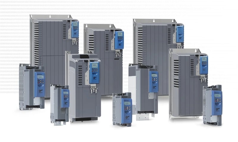

The entire NORDAC product line supports motors from 0.33 to 200 hp.
The entire NORDAC product line supports motors from 0.33 to 200 hp. Image used courtesy of Nord
