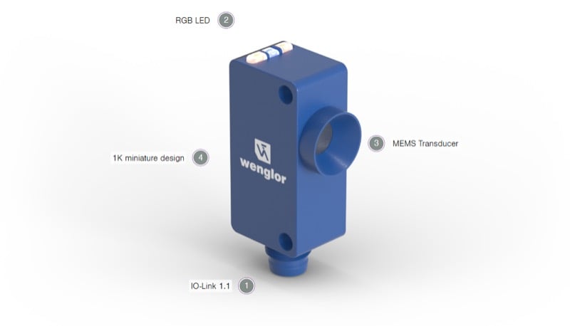

Wenglor has expanded its ultrasonic sensing portfolio with the compact U1KM series, combining a 3-meter sensing range, MEMS transducer technology, and IO-Link communication in a miniature housing. Designed for applications where installation space is limited, the sensors provide reliable object detection and distance measurement across a wide variety of materials. Features including multi-object detection, synchronized operation, and remote diagnostics make the U1KM well suited for packaging, logistics, robotics, and machine automation.
Wenglor has just added the U1KM series of ultrasonic sensors with a MEMS transducer and IO-Link communication.
Wenglor has just added the U1KM series of ultrasonic sensors with a MEMS transducer and IO-Link communication. Image used courtesy of Wenglor
The U1KM series is ideal for logistics, packaging, and machinery applications that require reliable object detection across a variety of materials. The sensors combine long-range ultrasonic sensing, IO-Link communication, and MEMS transducer technology in a miniature housing while supporting the simultaneous detection of multiple objects.

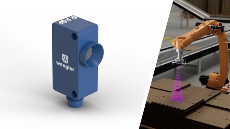

The U1KM will feature a miniature housing that allows the sensor to be adapted into almost any difficult area such as with robotic grippers, conveyor systems, and packaging equipment where larger ultrasonic sensors may not fit. Typical applications include pallet detection, fill-level monitoring, stack height measurement, and presence detection.
