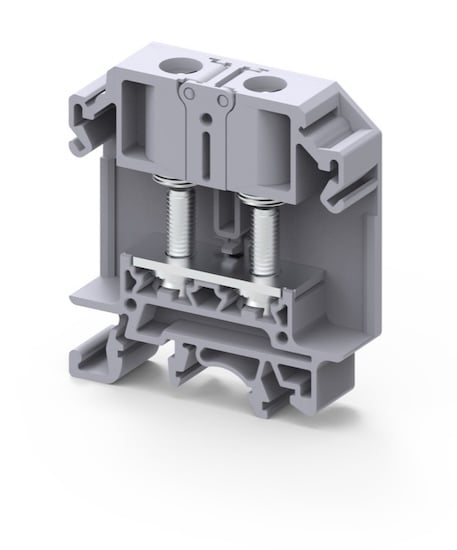

Electrical connections are a common failure point in industrial machinery, particularly in environments exposed to constant vibration. Altech’s new STH5 DIN-rail terminal block addresses that challenge with ring- and fork-lug connections designed to maintain secure electrical contact over time. Combined with a hinged finger-safe protective cover, the terminal block improves both reliability and worker safety. Rated for up to 85 amps and 600 volts, the STH5 is intended for demanding automation, motor control, and industrial control cabinet applications.
 The STH5 terminal block with hinge safety cover.
The STH5 terminal block with hinge safety cover. Image used courtesy of Altech Corp
The STH5 Hinge Terminal Blocks
When you need to make safe and secure connections between circuits within an industrial electrical cabinet, the terminal block is your friend. They come in multiple shapes, sizes, and connection types. The STH5 steps away from the crowd with a hinge cover protecting users from the conductive components. The connection is screw-type but designed for ring lugs crimped onto the wire end. The ring lug prevents loose connections caused by vibration, which can lead to short circuits, wire damage, and unexpected downtime.
The STH5 is rated for wire sizes from 22 to 4 AWG and can handle up to 600 Volts. Each terminal is rated for up to 85 amps and is considered finger-safe. While the STH5 supports ring-lug fasteners, it also supports fork-type lug connectors.

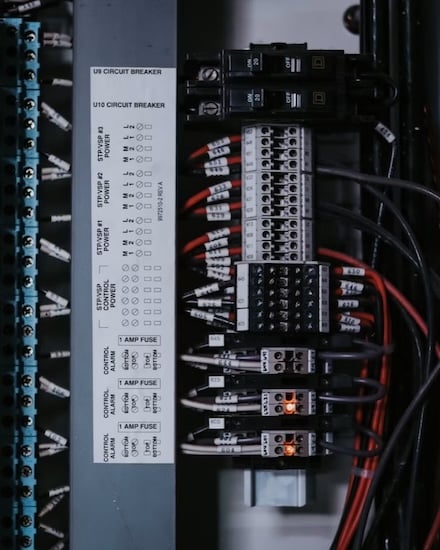

An industrial control cabinet that often uses terminal blocks.

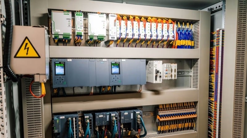

Electrical circuits joined with terminal blocks.
Electrical circuits joined with terminal blocks. Image courtesy of Unsplash
