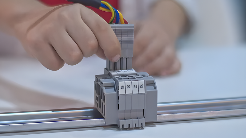

The new Altech / Connectwell pluggable terminal blocks reduce wiring time by eliminating the need for tools and screw tightening. Each wire is inserted into the plug in the required order, then the entire plug is inserted into the terminal block. This creates an error-free and secure connection that can be disconnected and reconnected without issue.

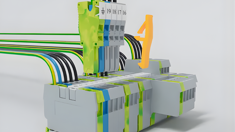

Altech's line of pluggable terminal blocks feature integrated locking pins, enabling connections to withstand vibrations. Image used courtesy of Altech Corporation

So why not just connect the wires directly to the terminal block? Some situations require constant connecting and disconnecting. Equipment that has changeover tooling for different part types might require different sensors or motor connections. By using a plug-style connection, technicians can quickly and easily remove the tooling from the panel.
Some panels have tight physical constraints, and technicians may not be able to fit a tool inside the panel to tighten screw terminals. With a plug-style connection, wiring can be done outside the panel and confirmed for accuracy before plugging into the circuit.
The pluggable terminal blocks are available as single, stackable blocks, or as pre-stacked blocks (up to 15 poles)
The pluggable terminal blocks are available as single, stackable blocks, or as pre-stacked blocks (up to 15 poles). Image used courtesy of Altech Corporation
