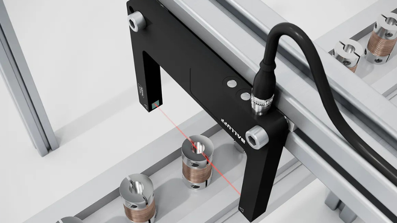

The new Balluff fork sensor family offers plug-and-play installation with options for standard, laser, and infrared sensing applications
The new Balluff fork sensor family offers plug-and-play installation with options for standard, laser, and infrared sensing applications. Image used courtesy of Balluff

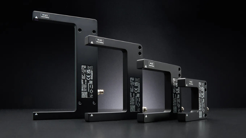

New-Generation Fork Sensors
Balluff also introduced a completely updated fork sensor family that ranges from economical Entry Line models to higher-performance IO-Link, laser, and infrared versions. All models share the same mechanical design, allowing existing installations to be upgraded without changing mounting hardware or sensor alignment.
The Entry Line targets cost-sensitive applications using a simple plug-and-play design, visible red light, and fork openings of 30 mm, 50 mm, and 80 mm. Sensors detect objects regardless of color or surface and use a zinc die-cast IP67 housing for industrial environments.
For applications requiring higher performance, the standard models add IO-Link communication, switching frequencies up to 5 kHz, improved repeatability, better ambient light immunity, contamination monitoring, remote configuration, and integrated pulse extension for capturing short-duration events. Balluff also offers laser variants for higher positioning accuracy and detection of very small features, along with infrared models designed for dirty or dusty operating environments.
Balluff’s optical fork sensors are ideal for determining part presence, identifying misalignments, or detecting features such as holes or slots
Balluff’s optical fork sensors are ideal for determining part presence, identifying misalignments, or detecting features such as holes or slots. Image used courtesy of Balluff
