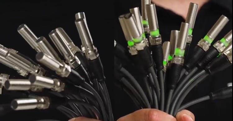

360-Degree Status Indication
A useful feature of the BES Entry Line is its 360-degree LED indicator. After installation, the back of the sensor lights up to show its status. Balluff says the display shows switching status, power supply status, and fault conditions such as short circuits. This makes it easier to spot problems and quickly identify sensor or wiring issues. When many sensors are installed close together, the visible indicator helps technicians find the one that needs attention.

The BES Entry Line’s 360-degree LED indicator simplifies troubleshooting in high-volume sensor installation.
The BES Entry Line’s 360-degree LED indicator simplifies troubleshooting in high-volume sensor installation. Image used courtesy of Balluff
