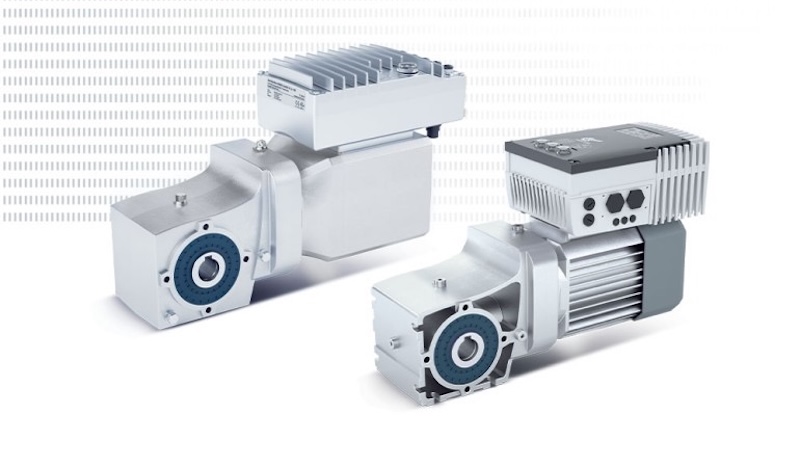

Two versions of the latest SK permanent magnet motor.
Two versions of the latest SK permanent magnet motor. Image used courtesy of Nord

SK 112 Synchronous Motor
The SK line of AC Synchronous motors uses a permanent magnet instead of an electromagnet to provide rotary motion at the output shaft. Permanent magnet motors are often smaller in frame size and more compact because they lack the copper windings required to generate the magnetic field. With an electromagnet motor, the magnetic field can be adjusted in strength and moved around the stator, resulting in higher torque, larger frame sizes, and variable speed control. The latest release of the SK line is the 112 frame size, which delivers up to 15 hp and up to 387 lb-in. All SK motors can be configured with ventilated fins for improved heat dissipation, smooth bodies, or an IP69K protection class for harsh environments such as the food and beverage industries.
Additional options include absolute or magnetic encoders, various flange mountings, and compatible gear units. Each SK model also comes equipped with a standard incremental encoder.

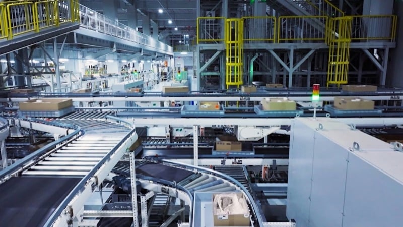

A large facility with many powered conveyors that would typically use AC synchronous motors.
A large facility with many powered conveyors that would typically use AC synchronous motors. Image used courtesy of Unsplash
