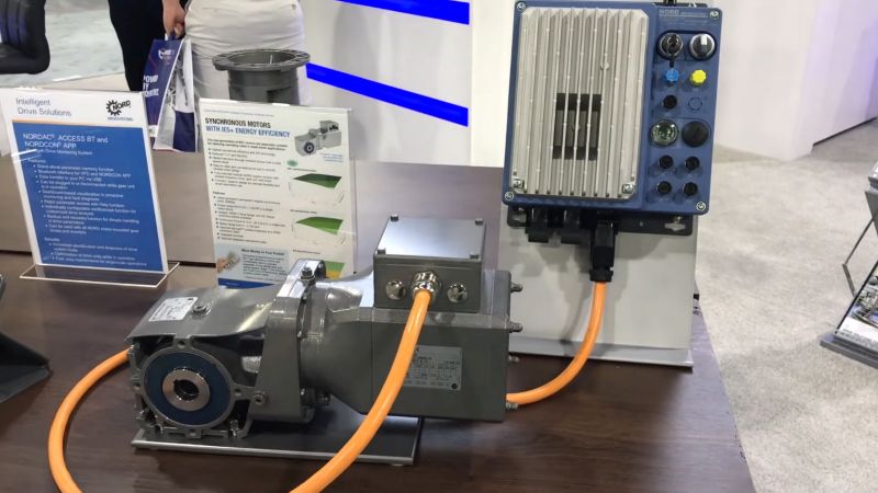

Nord’s IE5+ synchronous motor and drive system demonstration highlighting high-efficiency motor operation and integration with electronic control components
Nord’s IE5+ synchronous motor and drive system demonstration highlighting high-efficiency motor operation and integration with electronic control components. Image used courtesy of Nord Drivesystems

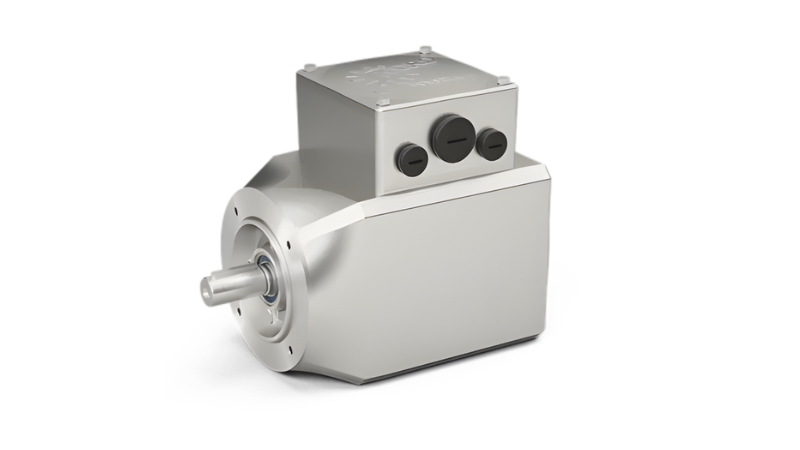

Ventilated and Non-Ventilated IE5+ Motors
Nord offers both ventilated (TEFC) and non-ventilated (TENV) versions of the IE5+ motors, depending on the intended environment. Ventilated TEFC models are available in all three frame sizes and use a finned housing to improve heat dissipation. These motors are commonly used in intralogistics systems where drives operate continuously.
For hygienic environments such as food and beverage production, smooth-body TENV versions are available in frame sizes 71 and 90. These motors feature corrosion-resistant surfaces that are easier to clean and can be supplied with IP69K protection, allowing them to withstand high-pressure washdowns.
Nord’s IE5+ synchronous motors with a non-ventilated, hygienic design
Nord’s IE5+ synchronous motors with a non-ventilated, hygienic design. Image used courtesy of Nord Drivesystems
