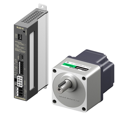

Oriental Motor has developed a new line of motors and motor drivers to outperform the typical scheme of 3-phase motor control inverters. The BLS line of motor controllers promises more reliable service with longer lifetimes than inverter-driven systems, all within a smaller footprint. The target markets for these motors are assembly lines, agitators, conveyors, and other applications with nearly continuous uptime.
The new BLS motor and driver.
The new BLS motor and driver. Image used courtesy of Oriental Motor

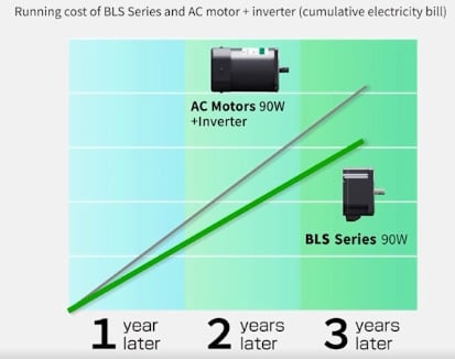

One of the key advantages of Oriental Motor’s BLS line is the potential energy savings. Inverters, particularly inexpensive ones, are lossy. The BLS Series products are much more energy efficient, leading to lower energy costs and reducing the facility's carbon footprint to meet ESG goals. Oriental Motor says energy usage is up to 20% lower than the average inverter system over the first three years of use.
Running costs of different motor schemes.
Running costs of different motor schemes. Image used courtesy of Oriental Motor
