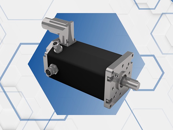

The BG 75 dMove integrated brushless DC motor features an integrated controller
The BG 75 dMove integrated brushless DC motor features an integrated controller. Image used courtesy of Dunkermotoren
The BG 75 dMove Motor
The BG 75 dMove is the latest addition to Dunkermotoren’s Motor Control Platform, a series of integrated DC brushless motors. The BG 75 is the second biggest offering from the catalog, with 810 watts of continuous output and a peak output of over 1,000 watts. The BG 75 operates on either 12, 24, or 48 VDC and is offered in three different frame sizes with nominal RPMs from 3190 to 3590 and a nominal torque of 0.528 to 1.436 Nm. The modular system is made up of a brake and encoder, the BG dMove motor, and a choice of gear reduction systems, either planetary or angular gearboxes.
To communicate with the motor, the BG 75 dMove utilizes Dunkermotoren’s Drive Assistant 5 software. Both status monitoring and integration can be executed using the software. The popular CANopen fieldbus communication protocol is used for issuing motion-related commands. If your application doesn’t support CANopen, digital inputs and outputs can be utilized instead.
