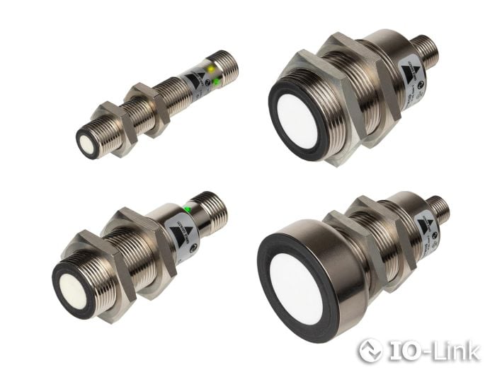

Carlo Gavazzi’s UA12, UA18, and UA30 ultrasonic sensor series features integrated IO-Link communication
Carlo Gavazzi’s UA12, UA18, and UA30 ultrasonic sensor series features integrated IO-Link communication. Image used courtesy of Carlo Gavazzi

The new series of ultrasonic sensors from Carlo Gavazzi are designed to detect difficult object surfaces in harsh conditions, thanks in part to the wide range of operating temperatures, from -25 °C to 70 °C, and the ability to resist interference from dust, fumes, and steam.

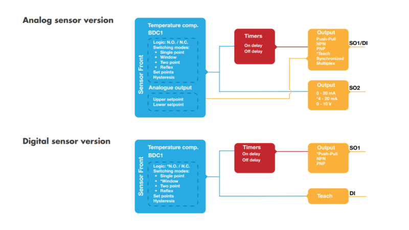

The sensors come in three sizes: M12, M18, and M30, all of which can be ordered as strictly digital-only output or combination output, one digital and one analog. Analog versions are 4 to 20 mA, 0 to 20 mA, and 0 to 10 VDC. The digital output can be configured as either push-pull, NPN, PNP, or Teach-in.
The sensing range is the distance from the sensor at which objects can be detected. The new sensors have a sensing range from 20 mm to 6000 mm, depending on the model chosen. Connection to the sensors is accomplished using a standard four-pin M12 connector, regardless of the sensor chosen.

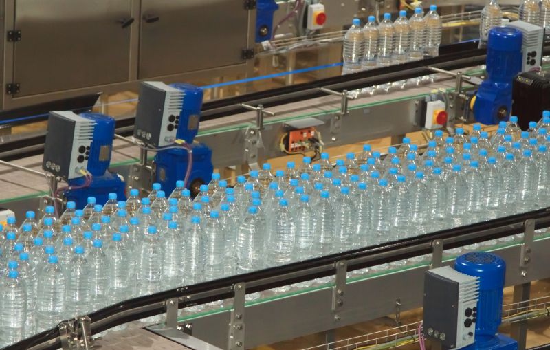

There are many applications for ultrasonic sensors, and the fact that they double as a distance sensor adds even more applications. Level monitoring is a common application for ultrasonic sensors because they can detect the level of transparent fluids, and they don’t need to make contact with the fluid. They also have a wide operating temperature and are not susceptible to steam, so if a process requires heating of a fluid, an ultrasonic sensor might be the right choice. Detecting transparent plastic bottles is another common use, as a through-beam or diffuse sensor might have trouble detecting the transparent surface.
Example of a bottling line with clear plastic bottles
Example of a bottling line with clear plastic bottles. Image used courtesy of Adobe Stock
