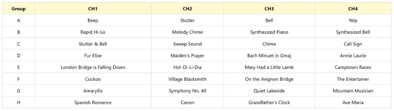

A key feature of Patlite’s BD series audible alarm is the inclusion of just the right number of potential sounds. There are 32 available sirens, alarms, buzzers, and other common sounds, selectable via a DIP switch on the back of the alarm. Furthermore, up to four sounds can be selected via bit input, making it possible to programmatically change sounds based on alarm conditions.
Once mounted, these DIP switches will take a little effort to change, which is ideal for the industrial environment, as technicians cannot change them easily. While some alarm systems offer the option to use an SD card for user-defined sounds, this can undermine uniformity across devices. Instead, similar devices can sound identical alarms, helping technicians locate problem machines quickly.
The BD-M alarm features a built-in sound library with 32 options
The BD-M alarm features a built-in sound library with 32 options. Image used courtesy of Patlite

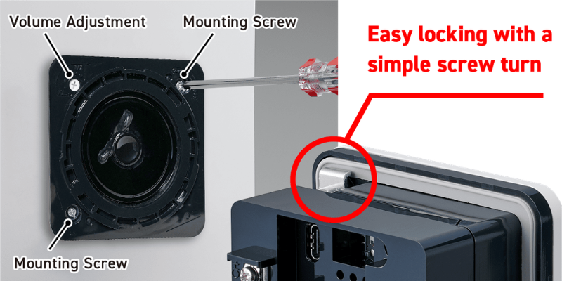

The panel alarm is IP65-rated and features a 4.5 G vibration rating, making it suitable for dusty or humid environments. Installing the alarm into a panel is simple, too. Turning a screw moves a small bracket behind the panel, solidly locking it in place. There is no need to fight small screws and nuts in a tight space. Technicians do not need to fight small screws and nuts in tight spaces or work from the back of the control panel; all installation can be performed from the front, once the DIP switches are set and the cabling is connected.
The BD-M’s screw-mounting mechanism allows for simple installation from the front of the panel
The BD-M’s screw-mounting mechanism allows for simple installation from the front of the panel. Image courtesy of Patlite
