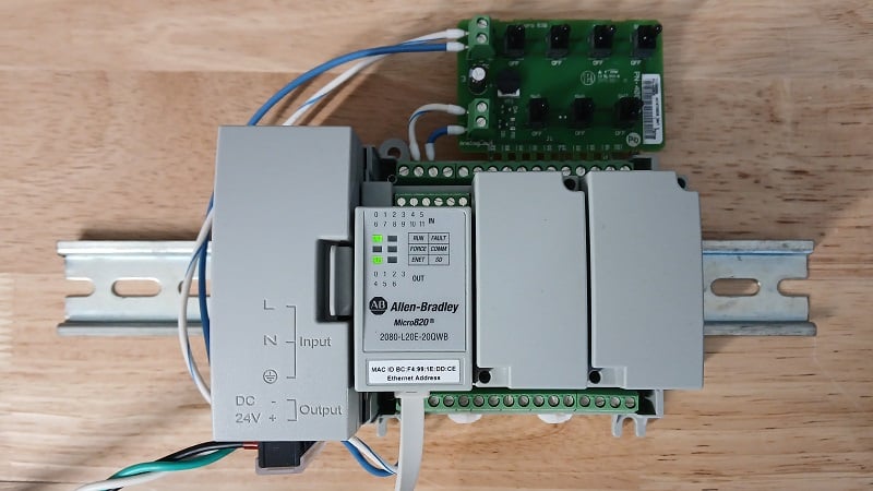

For my application, I will be using the simulator board provided with the PLC demo kit, but we’ll see how to install any pushbutton or switch in a similar manner.
 Figure 1. Micro820 with simulator I/O board.
The PLC requires 24 VDC to run. Using a standard industrial power supply, provide + and - 24 volts to the two left-hand terminals on the bottom of the PLC (viewed from the top).
For such a simple example project, we only need an input device; the indicator LEDs will be sufficient to test and verify the program when it’s working later.
If you don’t have the demo board from the starter kit, simply connect a pushbutton contact to 24 volts and connect the other side to the terminal labeled I-04. This will be input 4. We will use that input for this project, since inputs 0-3 work for both digital and analog inputs, so we’ll keep it simple for this first tutorial. Finally, connect the terminal labeled COM0 to the -24 VDC of the power supply.
Turn on the power supply, and the PLC power LEDs should light up. If so, we can move on to configuring the coms.

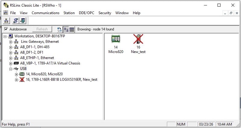

Open RSLinx Classic and go to RSWho. This window displays all the appropriate device drivers; USB should be in the list, as well as ETH and/or ETHIP (especially if you’re a former RSLinx user). If no USB device appears in the list, click Add a Driver, then select USB.
 Figure 2. USB Driver in RSLinx Classic.

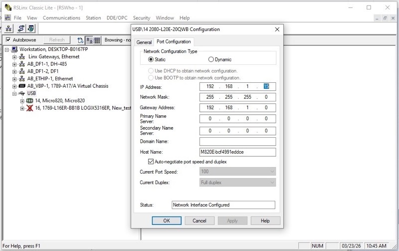

Expanding the USB device list should, after a few seconds, reveal your new PLC. Right-click the PLC, go to Module Configuration, then Port Configuration, and you should see some default settings.
By default, these PLCs will look for a dynamic address (DHCP). You may choose (as I have) to select a static IP address and set it to the same subnet as your PC's network card, only with a different last number. When you finish, press OK.
 Figure 3. Setting the IP address over USB.

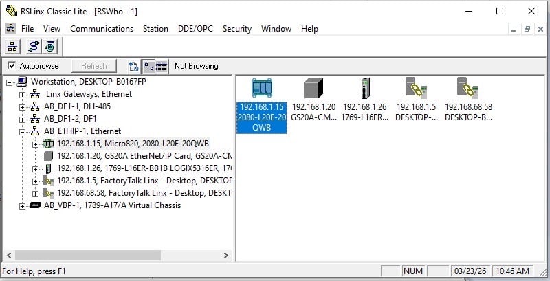

To test this address, disconnect the USB cable, and the device should disappear from the list, replaced with a red X icon. Next, install the Ethernet cable and expand the ETHIP driver list. The PLC, with its new IP address, should now show up in this list. If so, great job! Now we move to programming.
 Figure 4. Verifying the correct IP address.

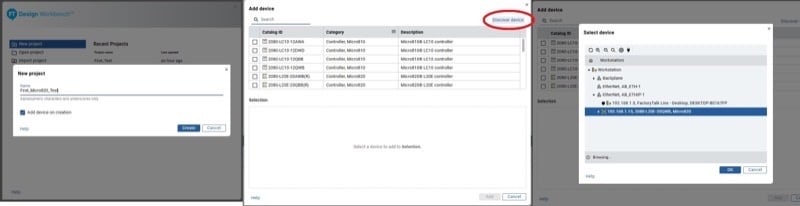

Open FactoryTalk Design Workbench and start a new project. I’ll name mine: First_Test. We will add a device on creation, but don’t go too quickly here–we can easily “Discover” the PLC, instead of adding it manually, which runs the risk of overriding the existing PLC and destroying our design work.
Click OK, then in the next window, click Discover in the top-right corner. Expand the ETHIP driver, then select the PLC with the IP address you recently designated. It’s probably the only Micro820 in the list. Click OK, and the creation process will complete.
 Figure 5. Creating a new project (left), discovering the live PLC (center), and locating the correct device (right).

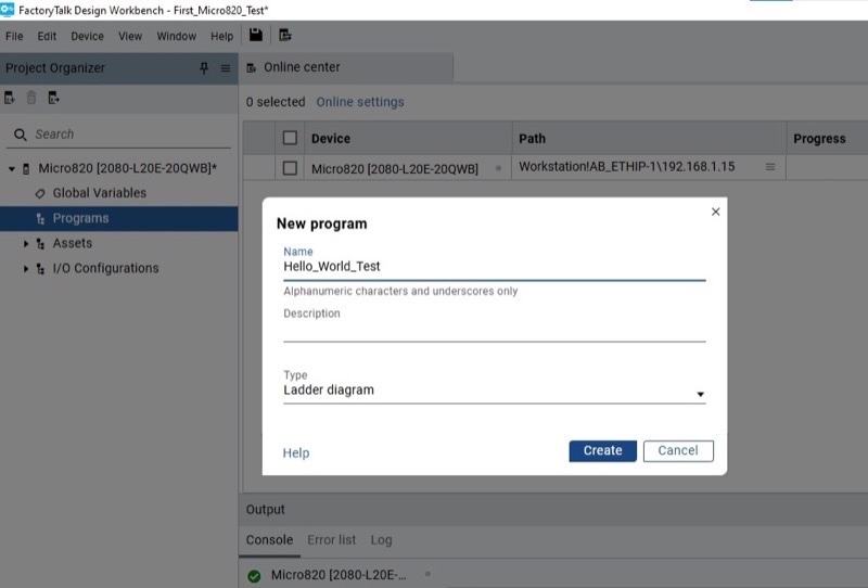

Now we can go offline and right-click Programs to create a new one; I’ll call mine Hello_World_Test with the type Ladder Diagram, since this is intended as a primer for those with more traditional PLC experience, where LD is a major player.
 Figure 6. Creating the new ladder program.

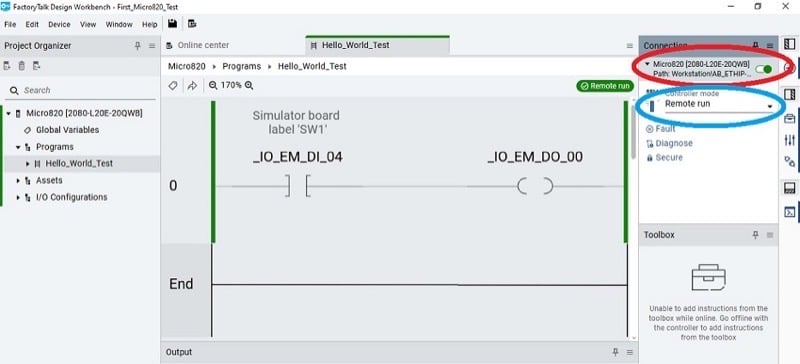

Double-click on Hello_World_Test, and we are presented with the LD window. The Toolbox on the right side contains the command elements. Drag an XIC to the rung, followed by an OTE.
For the XIC, provide the name _IO_EM_DI_04 (this translates to: I/O port, embedded, digital input, port 04). For the OTE, following this same logic, type _IO_EM_DO_00 for the first output.
Click the button on the right side to Go Online, and choose to download the current project. Ensure the controller mode is Remote Run, and the PLC should now operate as expected!
 Figure 7. The final ladder diagram and the controls for connecting (red) and activating Remote run mode (blue).
