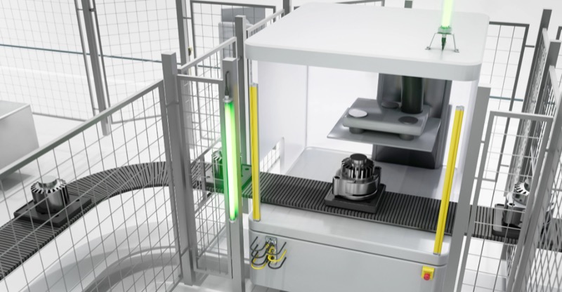

The new SmartLight Rigid is for compact illumination and indication applications.
The new SmartLight Rigid is for compact illumination and indication applications. Image used courtesy of Balluff

The SmartLight Rigid measures just 20 mm in diameter, so it’s much smaller than traditional stack lights. Its size allows users to install it directly on machines, inside enclosures, or throughout a system. Instead of relying on a central tower, engineers can place several units near key areas for clear, local status updates. This is especially helpful in complex or modular automation setups.

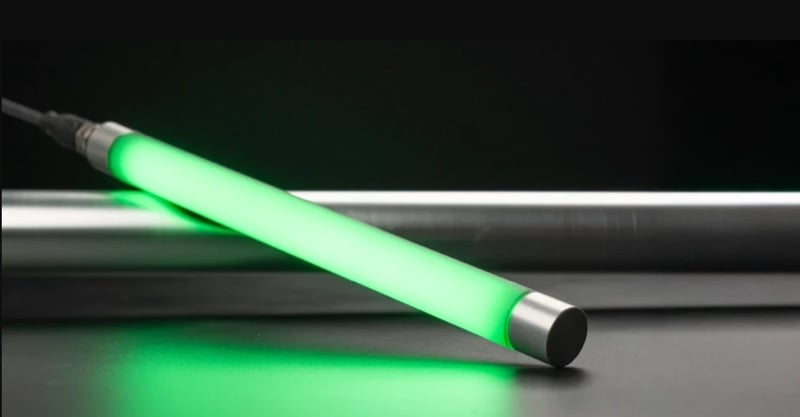

The new light offers high visibility and glare-free signaling in industrial settings.
The new light offers high visibility and glare-free signaling in industrial settings. Image used courtesy of Balluff
The SmartLight Rigid is available in several versions, including the BNI00LU and BNI00LP models, as well as other options. It uses an M12 5-pin connector and works with a single light segment. Features like blinking and sparkle effects add flexibility to how signals are shown.
