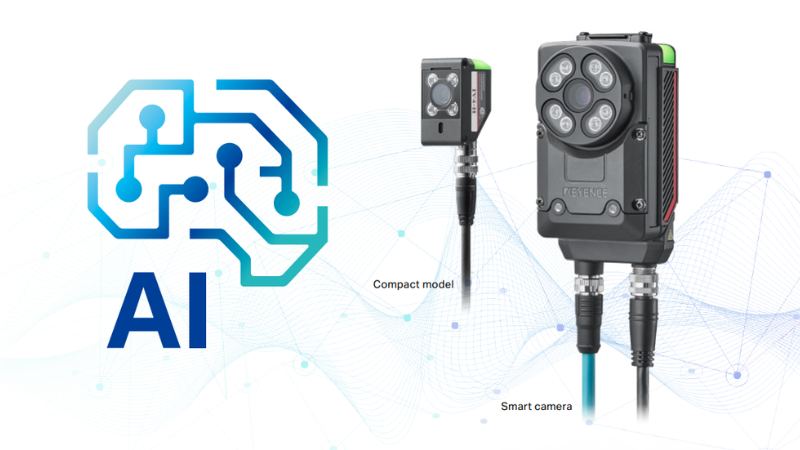

Keyence recently announced a new vision sensor that uses AI to aid in the development of vision parameters and speed up the training process. The company designed these new features to greatly reduce the learning curve for machine vision applications.
Keyence's latest lineup of vision sensors, the IV4-H series, features built-in AI

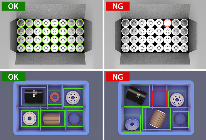

A typical application of the IV4, using AI to inspect the contents of an assembly
A typical application of the IV4, using AI to inspect the contents of an assembly. Image courtesy of Keyence

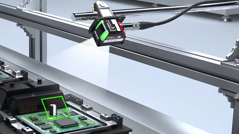

The IV4-H can be installed without the need for a hardwired or control trigger
The IV4-H can be installed without the need for a hardwired or control trigger. Image courtesy of Keyence
