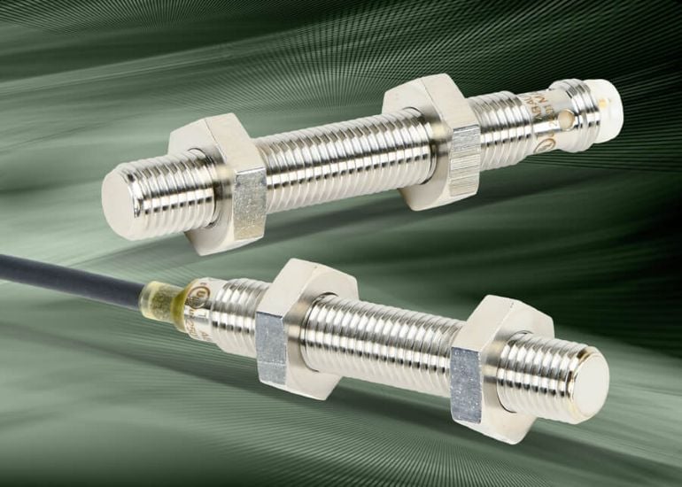

The new ProSense MAE1 magnetic proximity sensors offer compact, non-contact detection in demanding industrial environments
The new ProSense MAE1 magnetic proximity sensors offer compact, non-contact detection in demanding industrial environments. Image used courtesy of AutomationDirect
MAE1 Magnetic Proximity Sensors
AutomationDirect’s new ProSense MAE1 series of magnetic proximity sensors provides non-contact object detection. They feature a separate damping magnet for installation flexibility, offering long sensing distances of up to 60 mm. The proximity sensors can detect magnets through plastic, wood, non-ferrous metals, and stainless steel walls.
The series is built with a 316L stainless steel housing and features an 8 mm compact tubular flush-mounted design that can be installed to work reliably in tight spaces and challenging industrial environments. To further support a diverse system setup, the MAE1 sensors feature solid-state output (PNP NO) and offer flexible options, including a 2 m pigtail cable or an M8 quick-disconnect connector.
Each sensor model in the series complies with RoHS, CE, and UL standards and is backed by AutomationDirect's lifetime warranty, underscoring the company's commitment to delivering durable, long-lasting sensor solutions.
