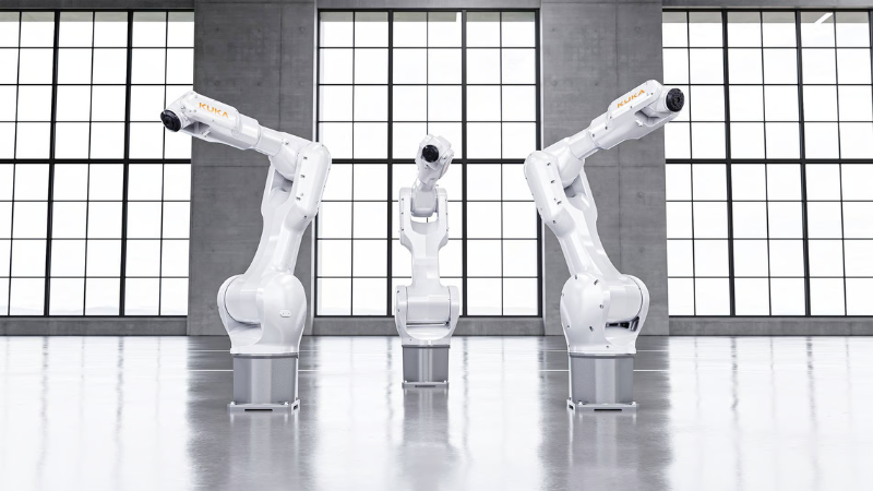

KUKA has added the KR AGILUS ultra to its small robotics portfolio as the next generation of the KR AGILUS platform. The robot offers improved performance compared to previous generations, with a higher rated payload of up to 16 kg, faster axis movements, reduced vibration, and improved positioning accuracy. As a result, cycle times are shorter, allowing the robot to perform dynamic handling, loading and unloading, testing, and inspection tasks more efficiently.
The combination of performance and compact size makes the KR AGILUS ultra suitable for electronics manufacturing, automotive production, and general industrial automation.
KUKA has expanded its KR AGILUS series with the compact KR AGILUS ultra
KUKA has expanded its KR AGILUS series with the compact KR AGILUS ultra. Image courtesy of KUKA
Designed for High-Density Automation Environments
The KR AGILUS ultra is available in multiple variants, with payloads ranging from 10 kg to 16 kg and reaches ranging from approximately 900 mm to 1100 mm. High rigidity and precise motion control enable the robot to handle complex tools, fixtures, or multiple workpieces in parallel.
Standard features include ESD protection, suitability for ISO Class 5 clean rooms, and global certifications for use in international markets. Typical applications include precision assembly, advanced semiconductor packaging, compact machine tending cells, inspection systems, and high-speed pick-and-place operations in consumer goods manufacturing.

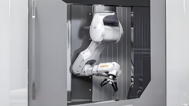

The KR AGILUS ultra maintains a small footprint despite its increased payload capacity. The robot supports full-angle installation, including floor, wall, and ceiling mounting positions. Control compatibility remains a key advantage. The robot operates with KUKA’s KR C5 micro controller and iiQKA.OS2 operating system. The platform provides a modern, web-based interface and supports multiple communication protocols for integration into existing automation systems.
AI readiness is included as part of the control architecture. KUKA intends for this to allow for future expansions and software-based enhancements as automation requirements evolve.
The KR AGILUS ultra features full-angle installation for ceiling, floor, and wall mounting
The KR AGILUS ultra features full-angle installation for ceiling, floor, and wall mounting. Image used courtesy of KUKA
