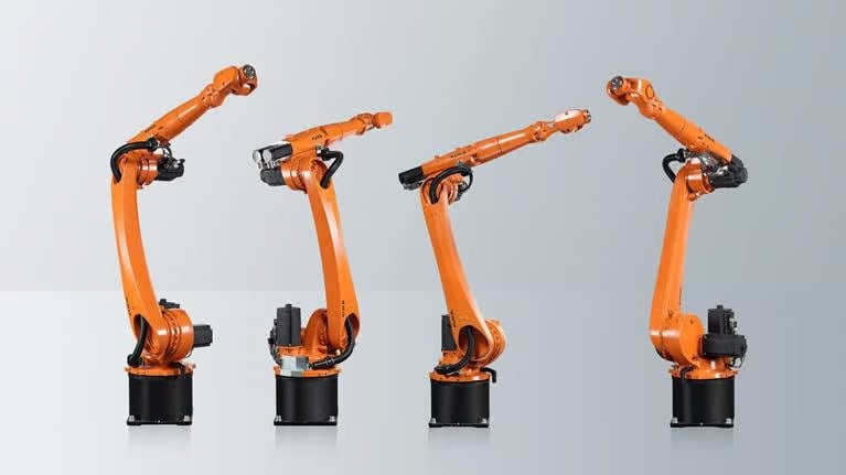

KUKA expands its KR Cybertech Lineup with 25kg and 35kg robots.
KUKA expands its KR Cybertech Lineup with 25kg and 35kg robots. Image used courtesy of KUKA

The KR Cybertech lineup has robots with capacities from 8kg to 35kg.
The KR Cybertech lineup has robots with capacities from 8kg to 35kg. Image used courtesy of KUKA

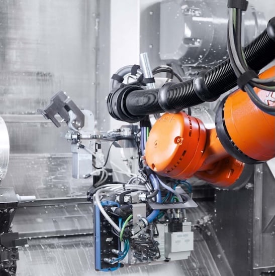

The KR Cybertech series is ideal for machine tending, photovoltaic wafer handling, or even surface treatment applications.
The KR Cybertech series is ideal for machine tending, photovoltaic wafer handling, or even surface treatment applications. Image used courtesy of KUKA
