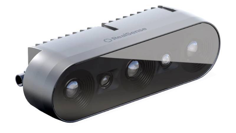

The D585 Pro features a 120° × 100° field of view at 60 fps, as well as an on-device AI inference engine
The D585 Pro features a 120° × 100° field of view at 60 fps, as well as an on-device AI inference engine. Image used courtesy of RealSense
D585 Pro AI-Native Vision
The RealSense D585 Pro is not simply a new and improved camera; it is a depth camera redesigned from the ground up to meet the needs of robotics and inspection tasks. Compared to previous RealSense models, it provides twice the depth quality.
In terms of viewing capability, the D585 Pro can perform high-resolution (1280 x 960) imaging at a standoff distance of under 15 cm, all at 60 fps. This enables the D585 Pro to capture more details at higher speeds, increasing throughput on a quality assurance line or providing higher-quality data for autonomous navigation.
Additionally, its 120° x 100° field of view is designed specifically for SLAM applications. AMRs with this camera will get the “full picture” of their environment, not just a narrow snapshot.

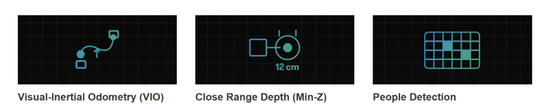

Perception Studio includes three key features: visual-inertial odometry, close-range depth, and person detection
Perception Studio includes three key features: visual-inertial odometry, close-range depth, and person detection. Image used courtesy of RealSense
Perception Studio Beta Program
RealSense also released a beta version of its Perception Studio. Perception Studio is a software package that extends the capabilities of the existing RealSense 2.0 SDK.
The beta features include improved sensing for the D400 line of sensors, human detection for SLAM and human-safety applications, and visual-inertial odometry (VIO). VIO is a method for combining visual data with inertial sensors to determine movement and paths more efficiently. More features will be available soon, and registered developers with Perception Studio will get early access.
The Perception Studio Beta Version is available for download to registered developers and includes downloadable binary files.
