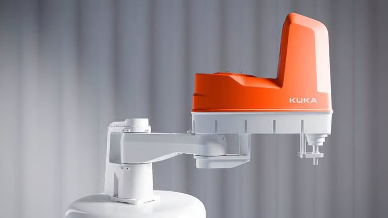

KUKA has expanded its KR SCARA robot series to include the KR 20 and the KR 60. The new robots can handle increased payloads and are available in multiple reaches, expanding the series’ range of application possibilities. The KR SCARA series expansion aims to help customers enhance efficiency and cost-effectiveness in their production processes, addressing the challenges of modern production.
KUKA has expanded its KR SCARA robot series to include the KR 20 (pictured above) and the KR 60
KUKA has expanded its KR SCARA robot series to include the KR 20 (pictured above) and the KR 60. Image used courtesy of KUKA
Latest KR SCARA Robots
KUKA’s newly-released four-axis robot, the KR 20, features a compact design and a payload of up to 20 kg. It is available with three reaches: 800 mm, 1000 mm, and 1200 mm. KUKA has designed the KR 20’s A1 axis with precision in mind, resulting in a rigid design for accurate and stable operation. The design also includes a cable connector plate on the top of the A2 axis, simplifying integration and installation into new and existing automation systems.
KUKA's KR 60 SCARA robot is designed to handle even heavier payloads, up to 60 kg, and features a reach of up to 1200 mm. This makes for a 1:2 payload-to-weight ratio without compromising the robot's rigidity and accuracy. Like the KR 20, the KR 60 also features simplified installation, as the four-axis robot doesn't require any steel structure mounting or planar referencing. The KR 60 will soon be released as an addition to the KR SCARA series.

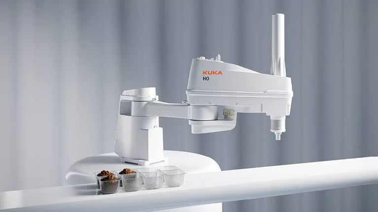

The KR SCARA robot lineup includes a hygienic oil series designed exclusively for the food industry
The KR SCARA robot lineup includes a hygienic oil series designed exclusively for the food industry. Image used courtesy of KUKA
Flexible Precision and Speed
In addition to the KR 20 and KR 60, KUKA's KR series has 6 kg, 12 kg, and 13 kg payload options. The 13 kg is exclusively available as a hygienic oil version, meaning it is specifically developed to meet the needs of the food industry. This is accomplished by using food-grade lubricants within the robot, ensuring that the robot can meet the standards where hygiene is paramount. Like its new releases, earlier KR SCARA robots focus on high precision, speed, and flexibility.
