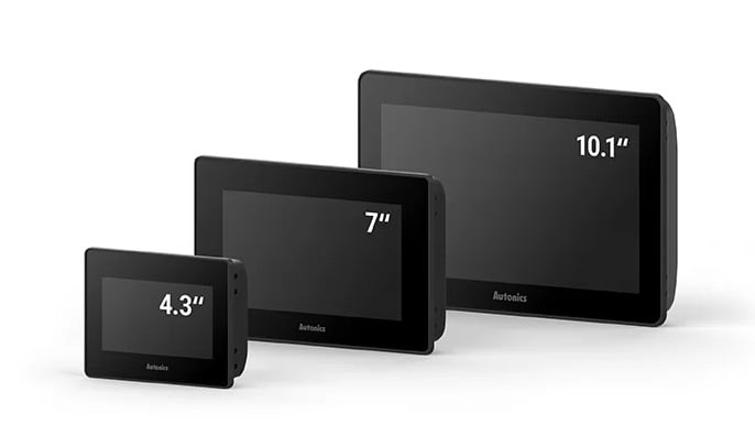

The TP series comes in three display sizes to accommodate different machine needs.
The TP series comes in three display sizes to accommodate different machine needs. Image used courtesy of Autonics
Multiple Sizes for Different Industrial Equipment
The TP series offers three display sizes, 4.3-inch, 7-inch, and 10.1-inch, to fit various machines and equipment. Each model features a 16M TFT color LCD and is made for industrial touch panel use. The panels are lightweight, with models weighing from 0.22 kg to 0.80 kg.
The HMI panels have a backlight that lasts over 50,000 hours, helping reduce the frequency with which displays need to be replaced or maintained. Having different sizes lets machine builders design operator interfaces that fit varying panel spaces or viewing needs.

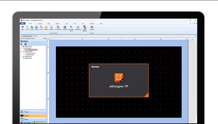

AtDesigner-TP software for monitoring projects, designing, and simulating tools.
AtDesigner-TP software for monitoring projects, designing, and simulating tools. Image used courtesy of Autonics
AtDesigner-TP Provides Dedicated HMI Development Tools
Autonics created the atDesigner-TP software for building and managing TP series projects. Users can edit screen layouts, shapes, properties, and other data. The software offers a library of images, screens, keypads, and visual effects for HMI development. It also supports overlap screens, checks data validity after downloading projects, and provides an online/offline simulator for testing designs. For monitoring and project management, atDesigner-TP includes VNC and FTP functions, and its communication features support real-time messages via SMS and email.
