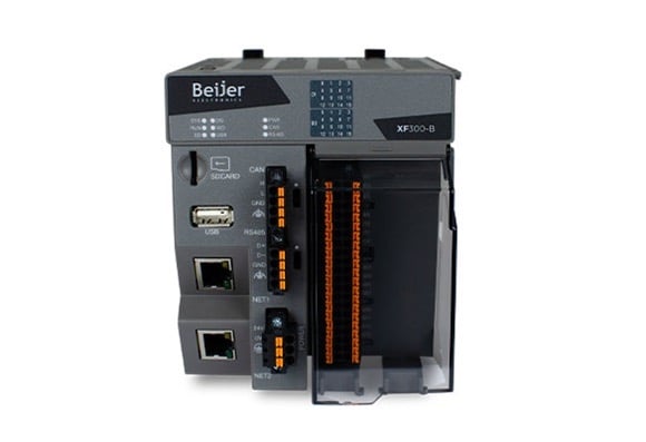

The Nexto XF lineup includes five CPU models with different I/O configurations. According to Beijer Electronics, the platform can execute up to 1,000 PID loops in less than 2 ms, making it suitable for applications that require several control loops to operate simultaneously. All five models include 16 digital inputs, nine of which are high-speed, and 16 digital outputs, including eight high-speed outputs. It also supports high-speed counter inputs, pulse train outputs (PTO), and pulse-width modulation (PWM) outputs.
The BCS-XF300-B supports OPC UA, MQTT, Sparkplug B, Modbus, and Ethernet I/P.
The BCS-XF300-B supports OPC UA, MQTT, Sparkplug B, Modbus, and EtherNet/IP. Image used courtesy of Beijer Electronics
The BCS-XF300-B and BCS-XF300 are the two basic configurations, providing digital I/O without built-in analog channels. The BCS-XF315 adds 10 analog inputs for applications that need to monitor signals from devices such as pressure, temperature, or level transmitters. Upgrading to the BCS-XF325 adds two analog outputs alongside the 10 analog inputs, letting the controller send analog control signals to compatible equipment.
The BCS-XF325-W rounds out the lineup with the same I/O configuration as the XF325: 10 analog inputs and two analog outputs. Beijer Electronics does not specify additional differences between these two models in the supplied information. Overall, the five configurations give engineers a choice between digital-only control and controllers with built-in analog I/O, depending on the equipment being automated.
