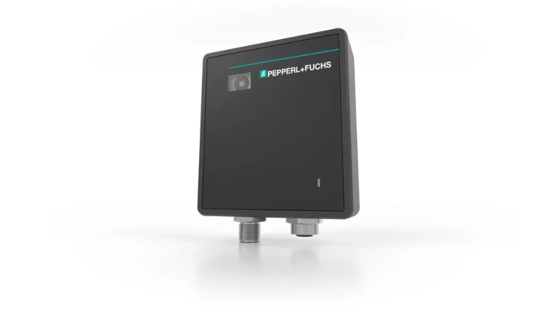

The VOC industrial event camera records videos and images for 900 seconds before and after a predefined trigger event
The VOC industrial event camera records videos and images for 900 seconds before and after a predefined trigger event. Image used courtesy of Pepperl+Fuchs
VOC Industrial Event Camera
Troubleshooting automation systems is easier if technicians can see what led to the excursion. However, scrolling through hours of video is inefficient. Pepperl+Fuchs has designed its new VOC industrial event camera to solve this problem. The camera is constantly recording, but it only saves events that matter. It records up to 900 seconds (15 minutes) before and after a categorized error, allowing technicians to focus directly on the events leading up to the fault.
The camera itself is loaded with important features, capable of full HD video and 12 MP still images. It includes a zoom function and automatically adds timestamps to images and video. The camera can be streamed with WebRTC or RTSP and integrates with other IT systems using REST API.
Each camera also supports multiple triggering methods, including changes in acceleration, changes in brightness, trigger signals from other cameras, and more. Trigger signals from other cameras can follow a product down an assembly line, a person moving through a restricted area, and other such situations.

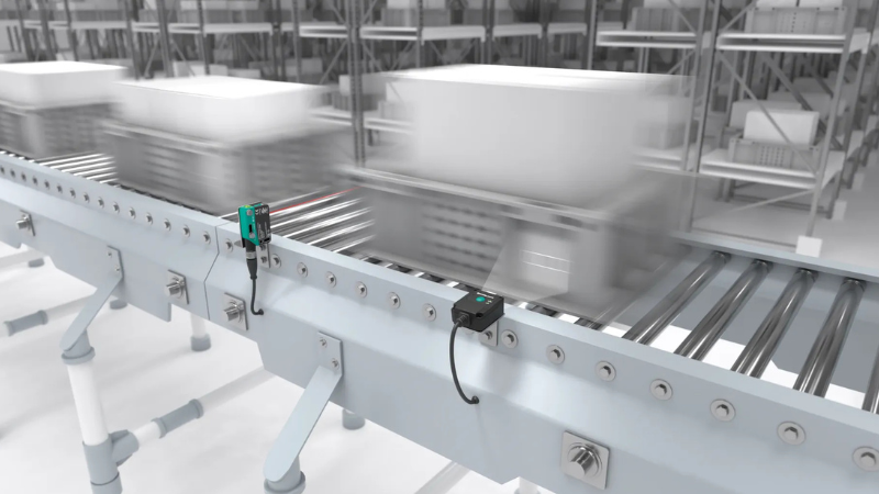

The CleverReader 1D/2D code reader scans bins on a roller conveyor
The CleverReader 1D/2D code reader scans bins on a roller conveyor. Image used courtesy of Pepperl+Fuchs
CleverReader 1D/2D Code Reader
Another new development by Pepperl+Fuchs is the CleverReader 1D/2D code reader. The new reader is designed to read both one-dimensional codes, such as bar codes, and two-dimensional codes, such as matrix, quick response (QR), or direct part marking (DPM) codes.
Designed for stationary mounting, the CleverReader reads items passing through its field of view at up to 3.5 m/s. Once the code has been successfully read, the software handles the rest. The reader includes a code comparison routine for matching reference codes to flag faulty objects. It also has an error-matching routine for items missing a code; they are flagged and imaged for additional inspection.
