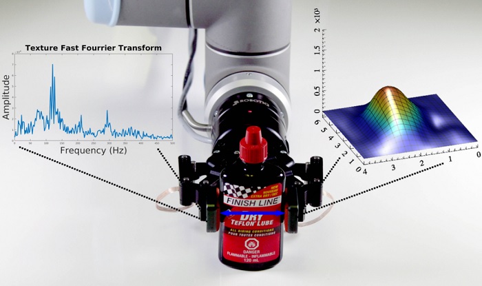

Robotiq, the Canadian manufacturer dedicated to end-of-arm tooling for robotics, just announced the TSF-85, a tactile finger kit that upgrades the sensing perception of ordinary robotic operations. This enhanced data-collection sensor can provide both pressure and vibration data with a resolution surpassing that of ordinary gripper feedback. This product intends to provide a new channel for data input to improve physical AI, where each pick can be analyzed to optimize future operations.
Robotiq’s new TSF-85 sensing fingers provide pressure and vibration data for gripping.

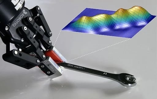

Robotiq has launched a complete solution wrapped into an efficient footprint. A 4x7 grid of pressure sensors provides a ‘feeling’ much like a pressure-sensitive touch screen. A soft neoprene coating adds flexibility but is also durable enough to grip virtually every part that was previously handled. The max force is 225 N.
The grip profile can be used to make more accurate motions.
The software development kit (SDK) can provide visual graphs of the gripping profiles. Let’s explore a few cases where this can be insightful.

Imagine gripping a cube with a hole passing through the middle. If only position detection is available, the robot would have no way to tell whether it was gripping a face with or without a hole. But when a 2D profile of the grip is available, the robot can detect the features, position, and orientation of the cube in the fingers, allowing far more accurate placement.
