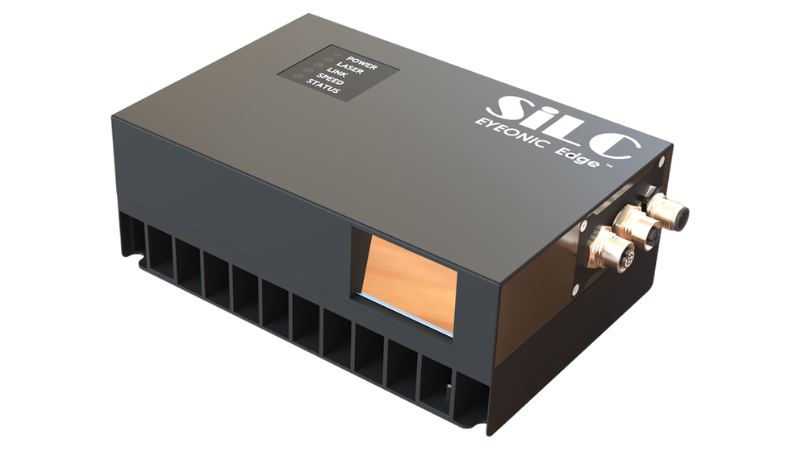

The new Eyeonic Edge 4D vision sensor for large object inspection
The new Eyeonic Edge 4D vision sensor for large object inspection. Image used courtesy of SiLC Technologies
