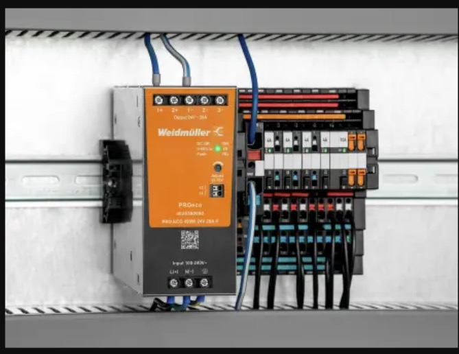

Weidmuller has introduced the PROeco II power supply series with Snap In technology, designed to speed wiring and simplify industrial panel assembly. Offering tool-free connections, up to 95 percent efficiency, and a compact footprint, the units target automation, machine building, and energy applications where space and reliability matter. With built-in diagnostics, wide temperature operation, and compatibility with modular power systems, the series balances performance with easier deployment and serviceability.
The new PROeco II PSU with Snap In technology for ease of installation.
The new PROeco II PSU with Snap In technology for ease of installation. Image used courtesy of Weidmuller
Designed for Faster Installation and Serviceability
The Snap In system is designed for speed and convenience, removing the need for tools and manual fitting. This reduces wiring time during both panel assembly and field setup, especially in systems with many connections. The design also supports automated wiring, making it suitable for robotic panel manufacturing. For maintenance, the system supports quick disconnects and connections, enabling faster troubleshooting and reducing downtime.
The new PSU series fits in compact cabinets with a slim profile.
The new PSU series fits in compact cabinets with a slim profile. Image used courtesy of Weidmuller
With a slim profile of about 100mm, these power supplies fit easily into compact control cabinets and match modern, distributed panel designs. Their low idle power consumption also improves energy efficiency, especially in systems that run continuously with changing loads.
