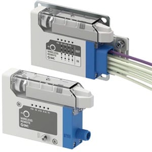

The SMC EXW1-RD wireless I/O module.
The SMC EXW1-RD wireless I/O module. Image used courtesy of SMC
Wireless I/O In The Factory
The latest addition to the EX600 lineup is the EXW1-RD. A modular wireless remote that is installed in the EX600 alongside digital and analog I/O. Once installed and configured, the EXW1 provides digital I/O over a wireless connection. The EXW1-RD does not expose the entire EX600 backplane to the wireless network; it exposes only the I/O on the EXW1-RD. Inputs and outputs connect via M12 grommet connectors and are IP67 rated. Configured for 16 inputs, 16 outputs, or 8 configurable inputs/outputs, the EXW1-RD provides modularity and flexibility for automation while using a proprietary secure wireless communication protocol.

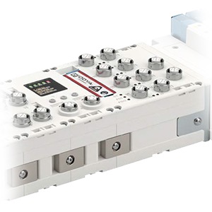

The EX600 with integrated safety I/O.
The EX600 with integrated safety I/O. Image used courtesy of SMC
Added Safety Protocols
Safety signals over a dedicated industrial network are quickly becoming the standard topology for medium and large automated equipment. The CIP Safety and ProfiSafe protocols use time-sensitive messages over an industrial Ethernet network to monitor door latches, servo positions, and reset light curtains. This technology reduces wiring and additional components, enabling faster, easier commissioning. The EX600 has safety I/O modules that allow OEMs to integrate safety inputs and outputs in the field, instead of running cables all the way back to the control panel. Recently, SMC has added ProfiSafe to the list of supported safety protocols.
The safety I/O module supports 16 inputs and 3 outputs, is SIL3 rated, and communicates over CIP Safety and ProfiSafe. These additions to the EX600 accessory lineup let machine builders and factories easily and safely send and receive signals while reducing time to market with fewer cable runs. The future of automation looks less crowded with unsightly cable tracks, thanks to wireless I/O and network-safe I/O.
