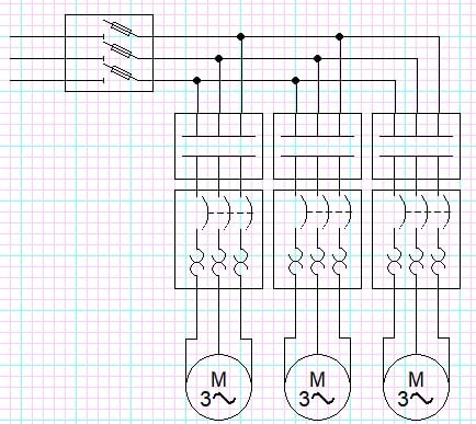

A common conveyor layout in a manufacturing plant is a modular belt system driven by many motors. Each motor drives a section of conveyor, and longer conveyors are constructed of multiple sections, straight and curved as required. Many of these motors need to start and stop at the same time. You could construct each motor with independent logic and contactor control, or you could wire all the coils of the contactors together so that all of the motors start at the same time… But is it possible to use only one contactor to control all the required motors in the circuit?

 Figure 1. A typical multi-motor layout with isolated contactors.
Figure 1. A typical multi-motor layout with isolated contactors. Image used courtesy of the author

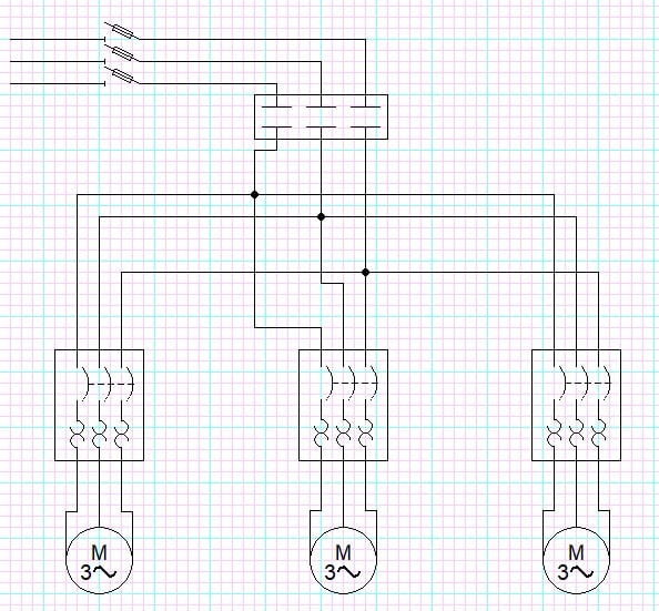

To run multiple motors off the same control circuit, you first need to make sure that the single controlling contactor must be rated for the sum of all the motors’ full-load currents, accounting for startup (inrush) amperage.
You will also need a distribution block to connect all the motors to the same circuit, as most contactors will only have three output terminals. So if you are using three-phase motors, you will need three distribution blocks that can handle all of the current required in the circuit.
Finally, you must ensure that each motor has its own overload protection. According to NEC standard 430.53 Group Motor Installation, each motor must have an overload sized for the specific downstream motor.
 Figure 2. Single contactor driving 3x three-phase motors.
Figure 2. Single contactor driving 3x three-phase motors. Image used courtesy of the author

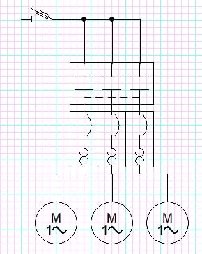

Sidebar note: Single-phase motors are a bit different, since 120 V, 1-ph motors have one live wire and one neutral, so a 3-pole contactor could supply up to three motors. On the other hand, a 240 V, 1-ph motor has two live wires, so a distribution block would be necessary for paralleling any multiple of these motors.
 Figure 3. 3x single-phase, low-voltage motors driven by one control contactor.
Figure 3. 3x single-phase, low-voltage motors driven by one control contactor. Image used courtesy of the author

In a typical control circuit, you would have a short-circuit protection device (fuse or circuit breaker) and a branch circuit protection device (overload) for each motor. Since we are trying to reduce the number of devices, we can use a single fuse to protect all of the motors within the circuit and only an overload device for each motor.
To size the fuse, use the largest motor's maximum allowed protective rating plus the sum of full-load amperages of the remaining motors in the circuit. NEC 430.53 also states that the short-circuit protection device must be sized to support starting loads of all connected motors; the system must not experience nuisance faults.
