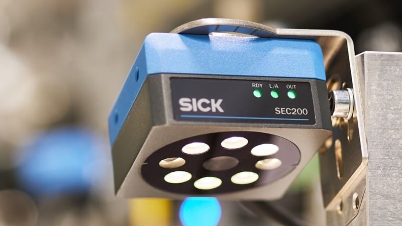

The SICK SEC200, mounted on a machine, ready to scan.
The SICK SEC200, mounted on a machine, ready to scan. Image used courtesy of SICK
