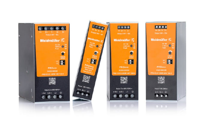

PROeco II is the latest upgrade to Weidmuller's established PROeco power line. The second-generation power supplies feature enhanced efficiency and a smaller footprint and are engineered specifically for high-performance industrial use. From automotive plants to food processing, the new series is designed to deliver stable, energy-efficient power distribution with robust thermal resilience and extended service life.
Weidmuller’s PROeco II power supplies are 15% smaller than earlier models, enabling use in applications concerned with space
Weidmuller’s PROeco II power supplies are 15% smaller than earlier models, enabling use in applications concerned with space. Image used courtesy of Weidmuller
PROeco II Power Supplies
The PROeco II power supply series features a significant energy performance boost, with up to 95% efficiency, according to Weidmuller, and ultra-low idle power draw. These power supplies minimize waste heat and reduce overall energy costs, a feature important in high-density installations with tight power budgets and cooling capacity. The improved thermal profile also leads to lower internal temperatures, helping to extend the lifetime of surrounding electronics and reducing the need for oversized heat management.
Designed for modern control cabinets, the PROeco II power supplies are up to 15% smaller than their previous-generation counterparts. The series is just 32 mm in width and 100 mm in depth, making it suitable for space-constrained cabinets and enclosures. Despite their smaller size, PROeco II power supplies are ruggedized for harsh environments, featuring reliable startup from as low as -40 °C and a Mean Time Between Failure (MTBF) exceeding one million hours. This level of durability equates to less downtime and fewer service calls over a system's lifetime.
The PROeco II power supplies are designed to deliver high performance and efficient power distribution across a wide range of applications
The PROeco II power supplies are designed to deliver high performance and efficient power distribution across a wide range of applications. Image used courtesy of Weidmuller
