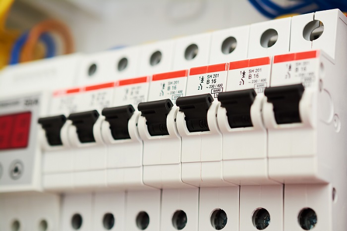

 Figure 4. Circuit breakers for branch protection.
Figure 4. Circuit breakers for branch protection. Image used courtesy of Adobe Stock
DC Branch Circuit Protection
Similar to the circuit protection for the AC side of the panel, the DC components will also require fuses or circuit breakers to protect circuits from over-current events. These devices are usually smaller, like slim miniature circuit breakers and fuses inlaid into DIN rail terminal block holders.
Typically, the DC branch protection will have more devices on each branch compared to the AC protection branches. This is likely due to the lower current consumption of DC devices like valves, relays, and contactors. Most DC protection devices have an indicator that shows when a trip has occurred. As a technician, this is likely where you will spend most of your troubleshooting time.
