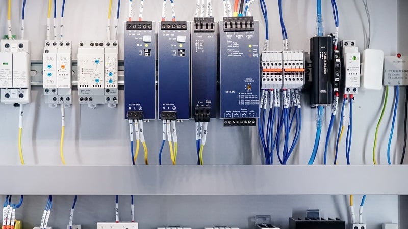

If signal architecture is the brain of a cell, power distribution is its pulse. Successful panels almost always follow a familiar physical layout:
  • High-power components (breakers, contactors, and drives) on one side
  • Low-voltage controls (PLC, I/O banks, and communication modules) on the other side
  • Safety devices occupy a clearly defined area near the center.
This spacing matters more than most people realize. Any electromagnetic noise coming off a VFD output line will couple into whatever wiring is nearby. If that wiring belongs to a sensor, an encoder, or an Ethernet module, you’ll spend days chasing problems that never seem to repeat exactly the same way.
Drive wiring deserves special attention. When power and I/O cables absolutely must cross, they should cross at ninety degrees to reduce shared exposure. A few more realities sometimes catch new integrators off guard. For example, if a VFD cable runs more than fifty feet, assume it will radiate noise unless you treat it accordingly. If multiple 24-volt loads share a single supply and startup currents are not considered, expect brownouts when the cell transitions from idle to motion.
The symptoms of poor power design are distinctive once you’ve lived with them for a while. Here are a few classic indicators that the power layout needs revision:
  • Robots dropping communication, but exactly when conveyors start
  • Drives tripping with undervoltage errors even though the incoming power is “within spec”
  • Sensors misreading, but only during acceleration
When power distribution is done correctly, you almost forget it exists. When it isn’t, nothing in the cell feels stable.

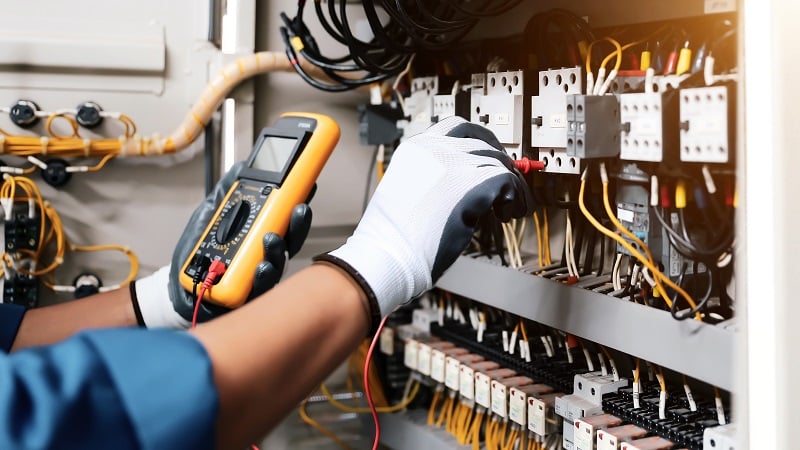

Before bringing a machine-tending cell fully online, a handful of checks makes an enormous difference in long-term reliability.
Measuring the 24-volt supply under load is mandatory; many supplies hold voltage when idling, but collapse when conveyors or brake coils activate.
Verifying shield bonds is equally important since a misplaced shield can turn into an antenna rather than providing protection.
Safety behavior should be tested in all reasonable conditions: open the door, confirm the robot stops; close it, confirm the system resets; and observe whether any steps in the sequence behave inconsistently.
 Figure 3. Testing low-voltage control wiring is a critical step before commissioning.
Figure 3. Testing low-voltage control wiring is a critical step before commissioning. Image used courtesy of Adobe Stock
Another valuable test is to rapidly accelerate the conveyor while monitoring the robot’s communication status. If the network drops, you know the power or signal routing needs attention.
Grounding should also be verified across the entire cell, as inconsistent grounding can cause tracking currents that degrade signal clarity. And every sensor should be tested with the conveyor running, not just during static checks. Many problems appear only under vibration or dynamic load.
