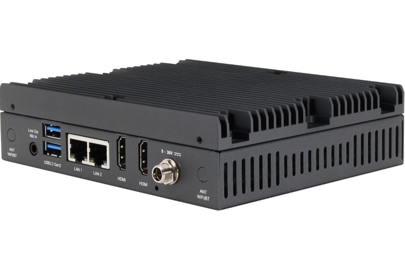

Aaeon’s brand Up has released the Intelli TWL01 Edge industrial computer. This compact computer features an Intel Processor N-series platform, dual 4K display ports, and many other key features. The IPC’s rugged design makes it suitable for high-vibration environments, such as a manufacturing plant floor, as well as for commercial applications, such as a customer interfacing kiosk.
The Intelli TWL01 Edge is an industrial multimedia PC powered by Intel Core Processor N-series CPUs
The Intelli TWL01 Edge is an industrial multimedia PC powered by Intel Core Processor N-series CPUs. Image used courtesy of Aaeon
Intelli TWL01 Edge Industrial Multimedia PC
The Intelli TWL01 Edge is designed for multimedia capability, yet built for the industrial, manufacturing, and commercial environments. It has two separate 4K monitor connections (HDMI 2.0b x 2) for high-resolution data display. The ability to clearly view key metrics at a glance cannot be understated in a fast-paced industrial environment.

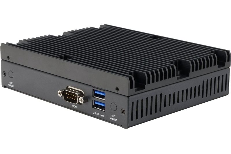

In addition to 4K monitor connections, the Intelli TWL01 Edge features an assortment of ports, improving interoperability between devices and making it easy to integrate with existing system architecture. It has two RJ-45 Gigabit Ethernet ports (plus Wi-Fi with an optional M.2 2230 E-key), an RS-232/422/485 port, four Type A USB 3.2 Gen 2 ports, a 10-pin GPIO, and two expansion slots. It also has two audio ports: an audio out for headphones or a speaker and a microphone port.
At the heart of the Intelli TWL01 Edge is a top-end Intel processor. The Intel Core Processor-N Series CPU (formerly Twin Lake) is available in four variants, all of which support Intel UHD Graphics and DirectX 12.1. The processor is optimized for use with Windows 11 LTSC, Ubuntu 24.04 LTS, or Yocto 5.1.
The Intelli TWL01 Edge features an assortment of ports, improving interoperability between devices and simplifying integration with existing systems
The Intelli TWL01 Edge features an assortment of ports, improving interoperability between devices and simplifying integration with existing systems. Image used courtesy of Aaeon

Building a computer suitable for industry or heavy-traffic commercial applications is not as simple as just getting a fast processor and the right ports. The computer itself must be rugged, easy to install, and power-efficient. The Intelli TWL01 Edge is no exception. It runs on 9 V to 36 V DC and is DIN rail-mountable, making it easy to integrate with existing hardware. Furthermore, it is fanless and has soldered memory for better stability in high-vibration environments.
