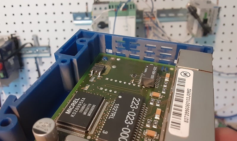

Dust Ingress (IP Rating)
Ingress protection is not a big deal in a clean office. But turn to a setting involving sawdust or metal particles, and even a small opening can be an open invitation for failure. Not only openings, but many standard switches use a fan for cooling, drawing air in across the PCB components to keep operation more efficient.
Some industrial switches are not entirely sealed, meaning you can’t be careless about placement, but they are designed specifically to withstand harsher environments that would destroy a typical network switch.
Dust inside a PCB enclosure
Figure 4. Dust ingress, while not always entirely preventable without an IP67 rating, can be minimized with proper installation (this is an IP30 switch).
Some are indeed rated as IP67 with fully sealed cases and ports, often using specialized cable terminators. This rating will certainly add to the cost, but it allows the switch to be installed in hostile environments. Most of these devices are not the DIN-rail mount, but rather are designed for installation directly on a machine. They usually have a longer, thinner profile with screw mounting holes at the top and bottom.
