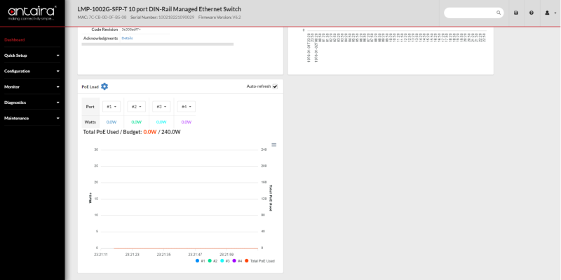

PoE load monitoring screen from Antaira’s software manual, page 14
PoE load monitoring screen from Antaira’s software manual, page 14. Image used courtesy of Antaira Technologies

Setting up a managed switch can be difficult because of the many options and advanced features. The LMP-0702G-SFP-24-T-V2 reduces this confusion with an operator-intuitive web interface. From the web application, users can monitor PoE and CPU load to prevent overloading the switch and for network optimization. Ring redundancy configurations can be set up along with specific switching ports. DHCP networks can be configured along with VLANs to create dynamic networks and reduce fixing IP addresses. Network Time Protocol (NTP) is a communication protocol used by many safely over Ethernet protocols. The NTP is used to ensure messages are sent and received on time. The NTP can be enabled and configured from the web interface.
The web application also includes a log and event warning feature to aid in troubleshooting and integration. Logs are sent to a syslog server that resides on the network. The type of message that is sent to the server can be configured. Event warnings can be configured to occur with specific system events. A relay output is used to set an indicator within the control system to the operator.

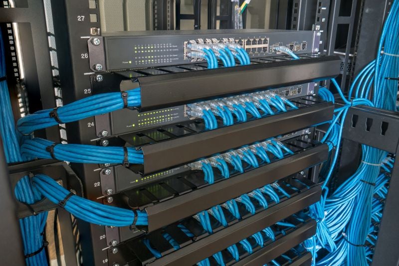

Network switches being used in an industrial setting
Network switches being used in an industrial setting. Image used courtesy of Adobe Stock
Industrial Networks
Ethernet switches used in industrial automation are often subjected to harsh conditions, time-sensitive messages, and industry-specific protocols. For these reasons, selecting the correct switch for applications is necessary. Protocols such as EtherNet/IP or ProfiNet require specific settings for NTP or speeds, while other protocols may not require these settings. With the Antaira web application, each port can be configured differently. This ability to use different port configurations allows designers and technicians to build networks that accommodate virtually any network device.
A common network topology involves connecting like devices or daisy-chaining multiple devices onto one port. This could look like multiple servo drives daisy-chained together and only occupying one port within the switch. Remote I/O devices can share a topology similar to that of servo drives but do not require the NTP settings that the servos will require. With Antaira's new LMP-0702G-SFP-24-T-V2 managed switch, topologies, such as those mentioned above, are possible with the web interface and advanced features.
