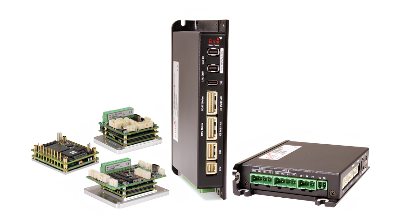

The Titanium line includes ultra-compact single- and multi-axis servo drives
The Titanium line includes ultra-compact single- and multi-axis servo drives. Image used courtesy of Elmo Motion Control
Titanium Line Servo Drives
Focused on optimized power density, the Titanium line of compact servo drives offers single- and multi-axis drives with integrated safety over FSoE or hardwired STO signals and synchronization of multiple axes with a single device.
The Castanet model supports motors up to 1.2 kW per axis for a total of 2.4 kW and up to 100 VDC at 15 A. Made up of stacked PCBs, the Castanet ranges in physical dimensions, measuring just 41 x 54 x 19.4 mm when equipped with a heatsink.
The enclosed Harmonica model shares the same safety features and multi-axis support as the Castanet, with support of up to 2.5 kW per axis at 200 V. A second version supports 1.6 kW per axis and 100 V.

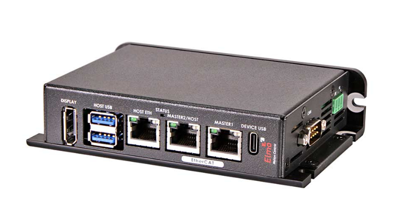

The Titanium Maestro motion controller supports up to 256 axes, with a 100 µs EtherCAT cycle time for 16 axes
The Titanium Maestro motion controller supports up to 256 axes, with a 100 µs EtherCAT cycle time for 16 axes. Image used courtesy of Elmo Motion Control
Anchoring the entire architecture is the Titanium Maestro motion controller. This controller features complex system coordination by managing up to 256 axes, achieving EtherCAT cycle times down to 100 µs for 16 axes to provide high speed and precision for demanding industrial applications.

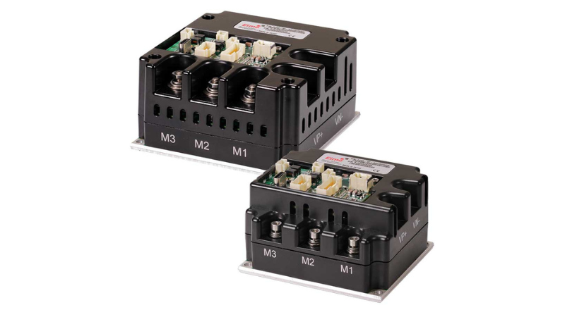

The Platinum line now includes the Jori 30A/60A (pictured above) and Cymbal servo drives
The Platinum line now includes the Jori 30A/60A (pictured above) and Cymbal servo drives. Image used courtesy of Elmo Motion Control
Expanding the series into higher power capacities are the new Platinum Jori and Platinum Cymbal servo drives. The Platinum Jori introduces Silicon Carbide (SiC) power stage technology, delivering up to 20/40 kW of continuous power in a compact package equipped with functional safety. Meanwhile, the Platinum Cymbal servo drive provides high power up to 17 kW, packing functional safety into a rugged, compact footprint designed for demanding environments.
