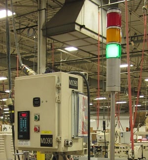

Layer 1: Manual Controls
The first type of HMI is the most basic: purely manual inputs. By definition, buttons, switches, joysticks, and other such devices represent a true HMI (interface between humans and machines). Often, these devices are binary, outputting an on or off state, but sliders, knobs, dials, and other such components allow for analog control.
At first glance, manual controls can seem outdated. However, some systems benefit from such controls. Consider a piece of industrial equipment that poses numerous safety hazards. There should be an emergency stop button within arm’s reach at any point in the machine. This E-stop should be a physical button, not a software button that is vulnerable to software crashes, but instead a physical disconnect.
Other physical buttons, switches, lights, and alarms provide tactile, visual, and sometimes audible feedback to the operator, giving more confidence that a process sequence has occurred.
 Figure 1. The stacklight notifies operators of machine status.
Figure 1. The stacklight is a purely manual signal, notifying operators of machine status. Image used courtesy of Wikipedia

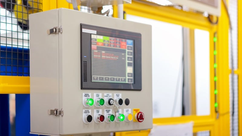

Layer 3: Displays and Dashboards
Stereotypically, when someone thinks of HMI, they think of displays and dashboards, like a regular industrial touchscreen display. While that is only one part of HMI, it is a critical part. A well-designed dashboard is a science better left to other articles, but in general, it will display only the controls and data that are required, and these items will be organized in a standard fashion with unambiguous labels. Buttons will always have the same format, and key functions will be located in the same place across dashboards.
One of the key benefits of displays and dashboards is the ability to customize the data that is displayed. For control room operators, they can log into a computer or desktop and see exactly the data they need for their job- and nothing else. This helps reduce errors in analysis by not cluttering up their vision with figures they do not need, as well as protect trade secrets by only allowing access to relevant data to their specific job role.
 Figure 2. A classic industrial HMI.
Figure 2. A classic industrial HMI. Image used courtesy of Adobe Stock

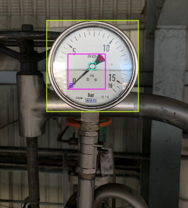

Layer 5: Machine Vision
Machine vision is an ever-expanding field. As higher resolution cameras with better detection routines become available, many industrial sites are using machine vision to monitor processes affordably.
One of the unexpected benefits of more robust machine vision is the ability to retrofit what was formerly too expensive to retrofit. Many chemical plants rely heavily on manual gauges that are simply too important to take out of service or too expensive to reliably automate. First, they installed cameras so that operators in a control room could monitor their readings remotely instead of having to walk out into the plant. Now, thanks to machine vision, the images of those gauges can be analyzed for trends. No new sensors or plant downtime required.
 Figure 3. Machine vision systems track the position of the needle in this analog gauge.
Figure 3. Machine vision systems track the position of the needle in this analog gauge. Image used courtesy of Universe Roboflow
