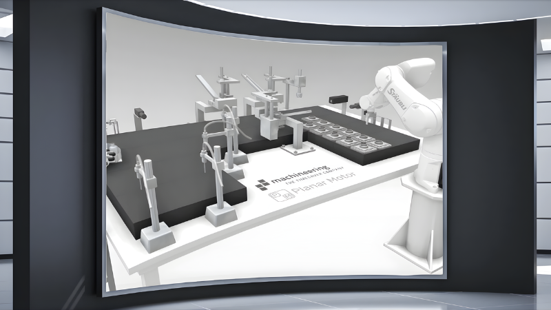

Designed for machine builders, the company’s iPhysics is a virtual world that interacts with control software, CAD data, and robotics to provide a process-accompanying tool that lasts the lifetime of the machine.
Machine builders can use Machineering’s iPhysics virtual commissioning software to aid their design process
Machine builders can use Machineering’s iPhysics virtual commissioning software to aid their design process. Image used courtesy of Machineering
