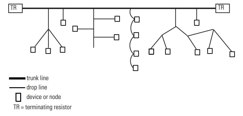

Figure 1. DeviceNet trunk/drop line topology. Image used courtesy of Rockwell Automation
DeviceNet offers both power and signal in a single 4-conductor cable to connect up to 64 devices, each with a specific node address. Power and signal in one cable can save on cost. Additionally, a trunk-and-drop line architecture makes integrating new devices relatively easy compared to Ethernet/IP, which often requires individual wires for each device. Additionally, DeviceNet’s architecture and individual node addresses work well for maintenance and troubleshooting.
DeviceNet is used to connect field-level compatible devices (like pushbuttons, limit switches, and some sensors), I/O modules, and motor drives to a PLC. As indicated in the name, DeviceNet is for device-level connections and limited sizes of data packets. In contrast, ControlNet facilitates communication between PLCs, drives, HMIs, and PCs, so the data size is much larger.

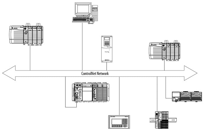

What is ControlNet?
Advanced automation and IIoT solutions require more data, faster speeds, and more reliable handling of data. ControlNet's fast speeds make it valuable in applications such as vision systems, weld controls, motion control, robotics, and more. Deterministic, redundant, and time-sensitive applications might choose ControlNet over DeviceNet or Ethernet.
ControlNet can use fiber optics, operate up to 1000 meters without a repeater, connect up to 99 devices, has data transfer rates of 5 Mbps, and offers multiple topologies. This network uses a logical token ring or token-passing BUS control network.
ControlNet visual image
Figure 2. Control-level devices on a ControlNet network must be equipped with proper CN adapters. Image used courtesy of Rockwell Automation
The timing is set by the network update time (NUT), configurable between 2 and 100 ms. This timing is made up of three parts: scheduled, unscheduled, and guardband. Scheduled service time is used to communicate with each node for time-sensitive or priority messaging. If a node has no data to transfer, it will still send a short message to show it is still transmitting. Without this communication, a provision in the ControlNet protocol will regenerate the token and send it to the next node in the ring.
Unscheduled service times can be used for non-time-critical messaging. This separation allows critical messaging to be sent over the network without interfering with time-sensitive controls and I/O data. The guardband helps ensure that the scheduled and unscheduled service times don’t interfere with one another.
ControlNet also uses Requested Packet Intervals (RPI) to determine how often I/O data will be transmitted during the scheduled NUT. In short, the NUT tells you how often the network or ring updates, and the RPI tells you how often a device is asked to transmit on the network.
